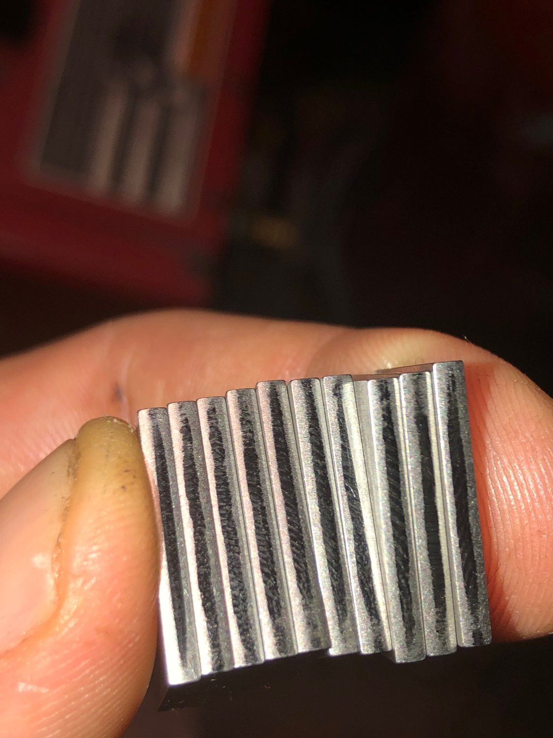

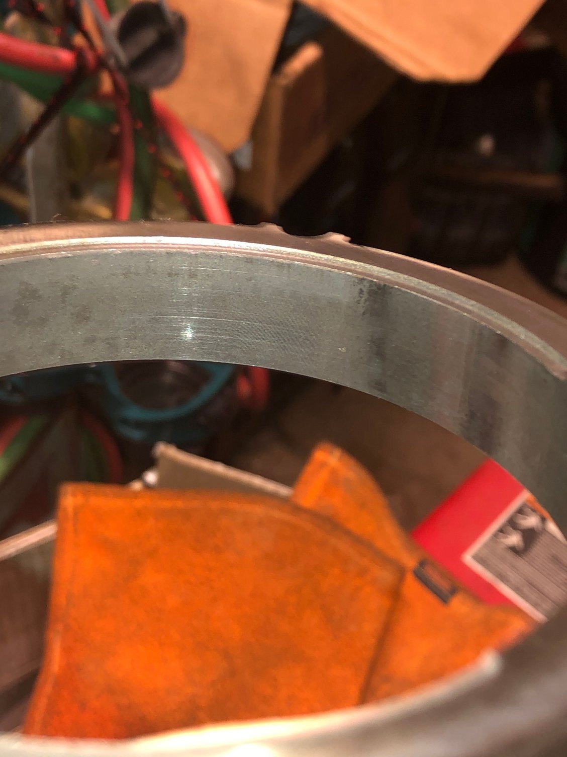

I’m getting close to finishing my transmission, it just occurred to me that what is gray coating on my old pump slide. I know I mentioned my old parts in other related threads. Also here are some pics of my old vanes, I’m having a gut feeling that I should use the old pump parts. There is guy named Hiram Gutierrez on YouTube that mentioned the gray coating on the pump surface.

I watched Hiram's disassembly video for the 4L60E back in 2014 because I couldn't get the band anchor pin and band out of the case.
What is the nature of the gray coating? Is it a factory applied coating or some kind of burnishing or wear that happens from being in operation?

I guess the gray coating is a sign that the part has very little wear. How come does my new slide does not have it. I know everyone is hi performance driven on this forum, I just want my transmission back to like it was before, I wish I could find an NOS ac delco pump

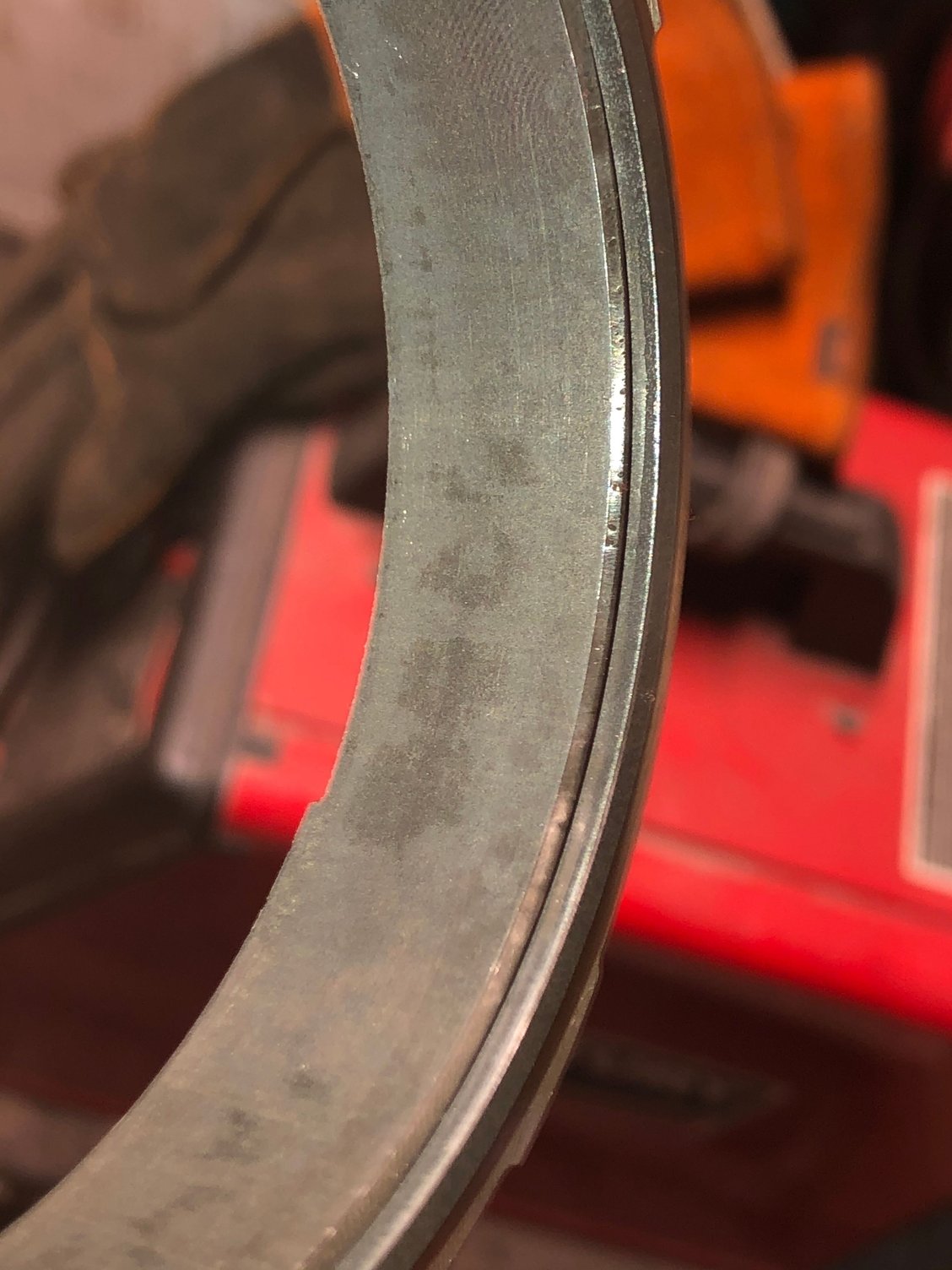

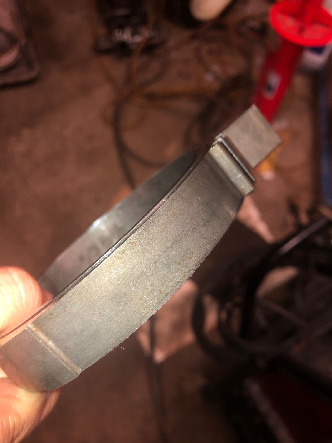

Here is another pic of the slide where vanes don’t ride. I’m not an expert on metallurgy but I guess it might some kind of salt bath nitriding or parkerized finish. I don’t see this kind of finish on any other pump repair kits that are aftermarket.

Oh I forgot to mention the new slide has an almost mirror finish in the area where the vanes ride. In addition to this I mentioned in other related threads there are subtle differences in terms of dimensions. Can anyone who is fluid dynamic engineering field possibly chime in. No offense to the other guys out there I’m sure they know their stuff as well. Maybe any SAE guys out there???

I went back and FF'ed through Hiram's 4L60E Transmission Teardown Inspection - Transmission Repair video where he mentions the gray color of the pump slide around the 35-minute mark.
He eludes to the gray surface color being there when the parts are new and gets worn off as the mileage accumulates. His conclusion was it wasn't new, but wasn't worn out either.
I think the gray isn't so much a coating but a result of the manufacturing process of the parts. Your replacement parts probably didn't go through the same manufacturing process as the ones being replaced. There isn't any data to support this, but I don't think you can say that the new, shiny parts aren't as good or better than the originals.
