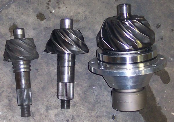

I try not to install any Dana-60 differentials into vehicles in my shop unless they are making at least 1,500+ HP.
I really prefer an extremely well tailored 12-Bolt for anything under 1,000 HP.
But I use all of GM, Ford, Dana, and custom Diffs for project cars depending the vehicles Power-Train.
I also like the jumbo versions of the Ford 9" (IE: 10", 11", or 12" ring-gear: 9+ Diffs for builds up to 3,500+ HP.
Check out these aftermarket 9" Ford based Pinion-Gears... 9.5", 10", and 12" gear sets:
All 3 Diffs (12-Bolt, 9", and Dana-60) have their flaws stock...
The amount of broken Ford 9" Diff housings is laughable!!!
All 3 have been improved by the aftermarket to minimize their weaknesses...
They all still each have PROs and CONs compared to one another...
But they all can be built very nicely and made to work for a broad range of uses and power levels.
By far, the 9" Ford based SUPERSIZED Differentials have become the KING of Massive-Power rear-ends...
