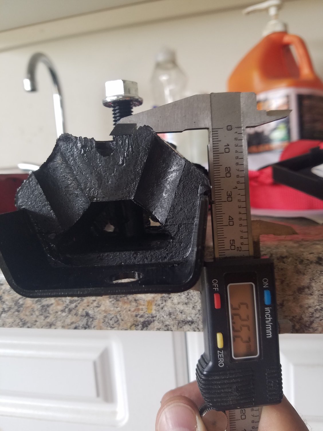

Here are height measurements of the two pieces and a profile picture of the rubber mount:
Rubber mount = 52.5mm
Poly mount = 45.9mm
Cleaning the trans crossmember and hardware took more time than removing and reinstalling the trans mounts. I did find that the mounting bolt was just a hair off center. Even with the adjustment slots in the crossmember, I had to give it a nudge over to get one side of bolts in.
