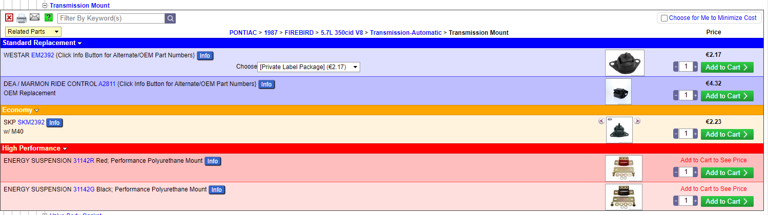

.if I change on rockauto of years and take 1988, the model change for https://www.rockauto.com/fr/moreinfo...51481&jsn=1667
many many sort of .............

Shouldn't make much difference. The transmission and crossmember was the same from 83-92. All the slotted holes will line things up if the crossmember and mount are shifted around. The second style mount is probably the better choice, but both should bolt up "OK".

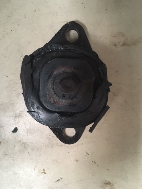

Original mount transmission on my trans am GTA 1987 with th700
new westar EM2392 who don't work, bad aligment, and recommended by Rockauto ......
2,17€ is nothing but there is 13€ to cost of transport
I want to get some Polyurethane but the total price is : 50€ ok no problem if no vibrations
