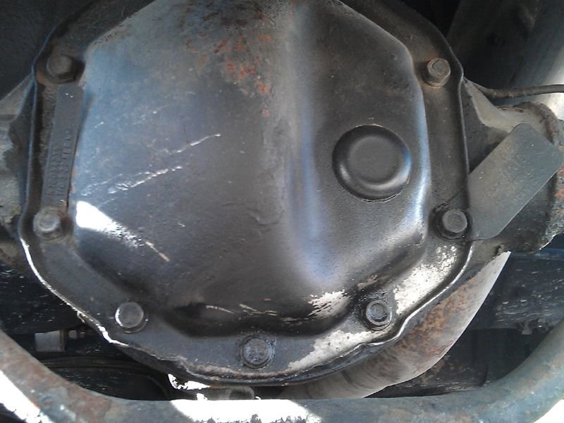

Normally a 1988 model with a disc-brake rear differential; would have originally had metal tags attached to the differential inspection cover (via the cover bolts).
Notice the metal tags on both the Left and Right sides of the inspection cover... shown below:
Most of these cars would have had a 2.77:1 or 3.27:1 ring and pinion gear-set (Borg Warner).
The Highest optioned 5.0L and 5-Speed combination IROC-Z cars (few 350s had this option) had a 3.45:1 gear-set (Borg Warner).
But 3.70:1 gears "stock" are so rare, that I do not think another will be found again.
There were "Dealer Package" installations with 3.70:1 gear-sets (Borg Warner) as well as a very rare "Dealer Package" 3.92:1 gear-set (Dana 44).
Also there was a GM Warranty-Repair Program...
Where if a vehicle with one of the Borg Warner differentials had repeat failures... a 3.31:1 or 3.92:1 (Dana 44) would be installed.
