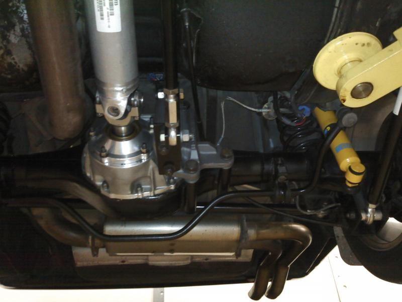

Probably still have my invoice but not 100% sure when . I do remember it was when Lingenfelter put them on a closeout sale.
Edit: Here is a picture of some of the decal. Don't mind the undercoating that's half scraped off and covered with trans fluid from a past 700r4 explosion.
Another not very good picture
