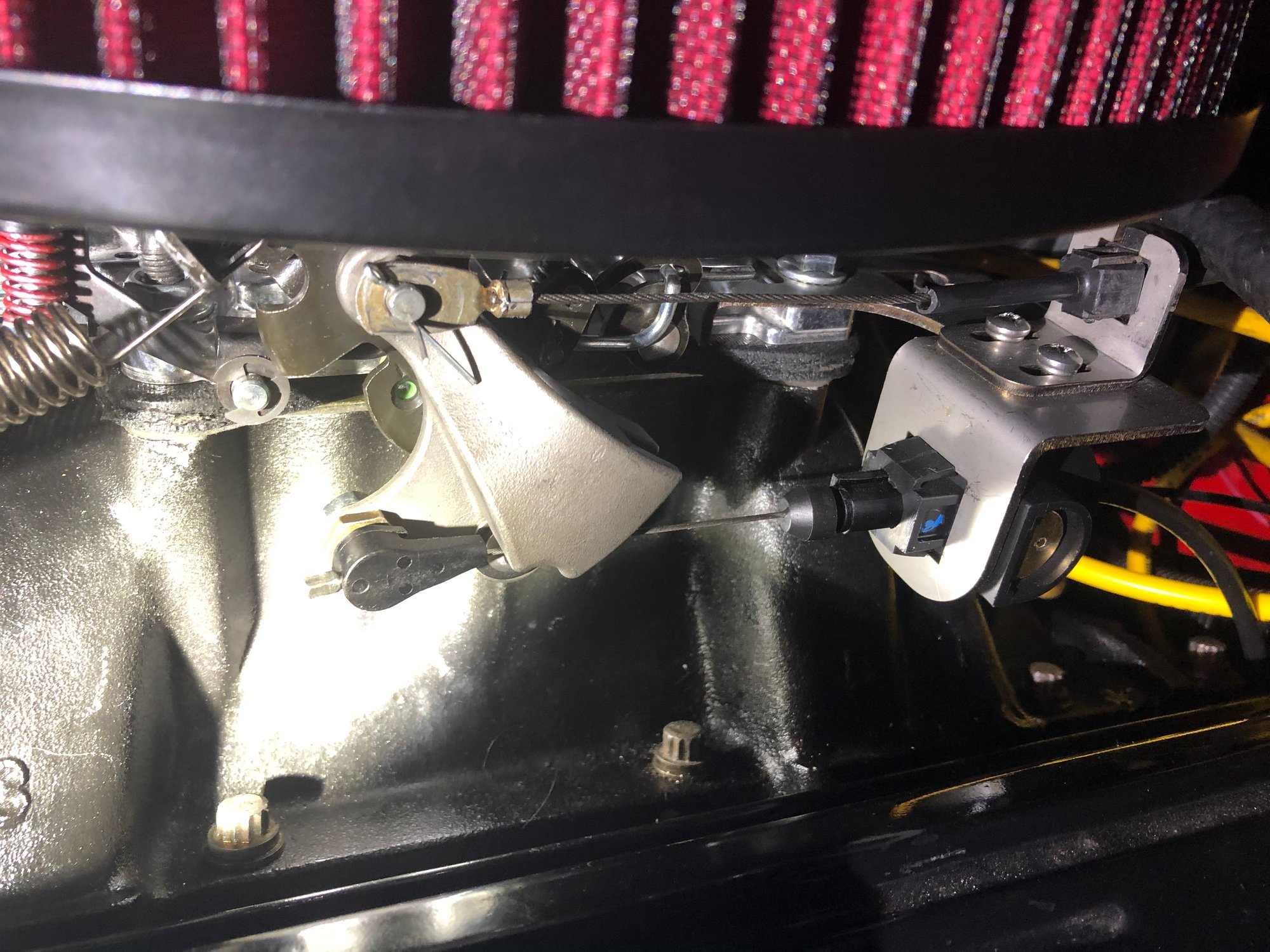

I had been using the Holley geometry corrector and the typical associated bracket (and modified/lengthened) to accommodate the stock throttle cable, transmission shifted fine when the car was dropped off, the reason for upgrading it was for more of a safety net since I was going to be making a lot more power.
Well when I got the car back long story short they failed to install the geometry corrector or even address that it needed to be on the carburetor linkage. I suspect they removed it and left it off because it did not fit the spread bore linkage on the side of the carburetor. The transmission shifted violently and late and they tried saying it was due to it being built, etc. (mind you, Even before I got the car back, the holley bracket and geometry corrector was janky and not very rigid, and the WOT shifts were never the same as factory TBI/TPI, more on that later)

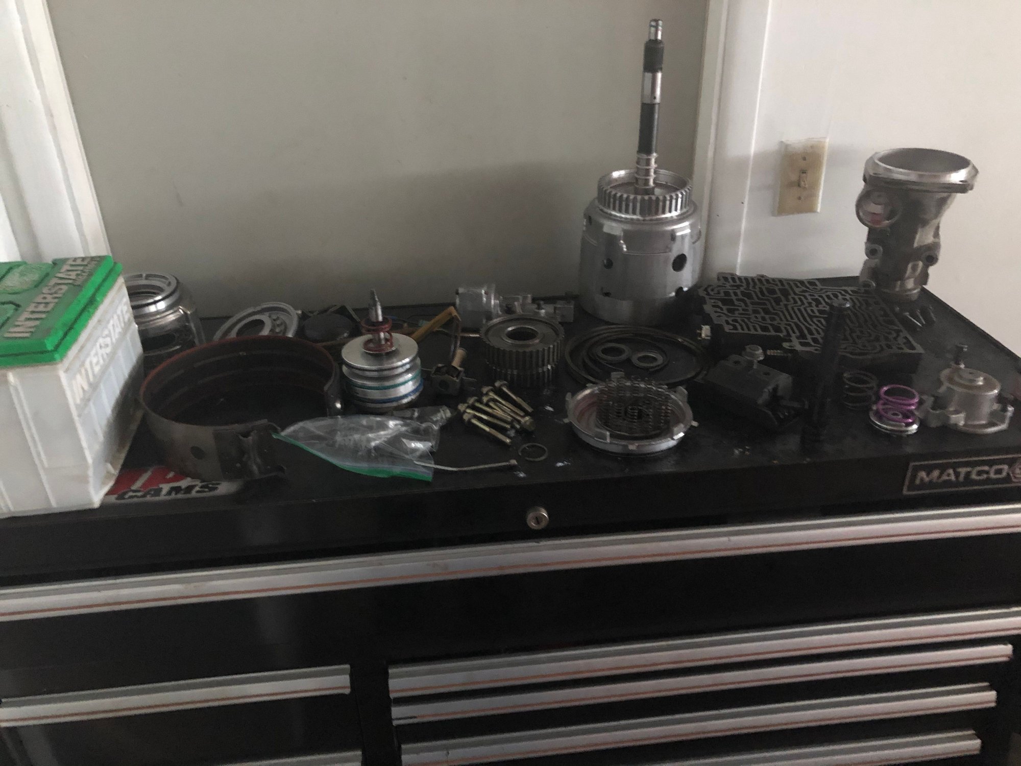

I bought a 700r4 rebuild book, watched a bunch of videos, removed the transmission myself , took it apart and found the 2-4 apply band was fried, the reverse input drum had black burn spots and was scarred from the band, and the engine brake /overrun clutches were also fried. Somehow nothing else was damaged, even the 3-4 clutch pack looked new.
I had it down to the bare case and had gone through with a master rebuild kit.

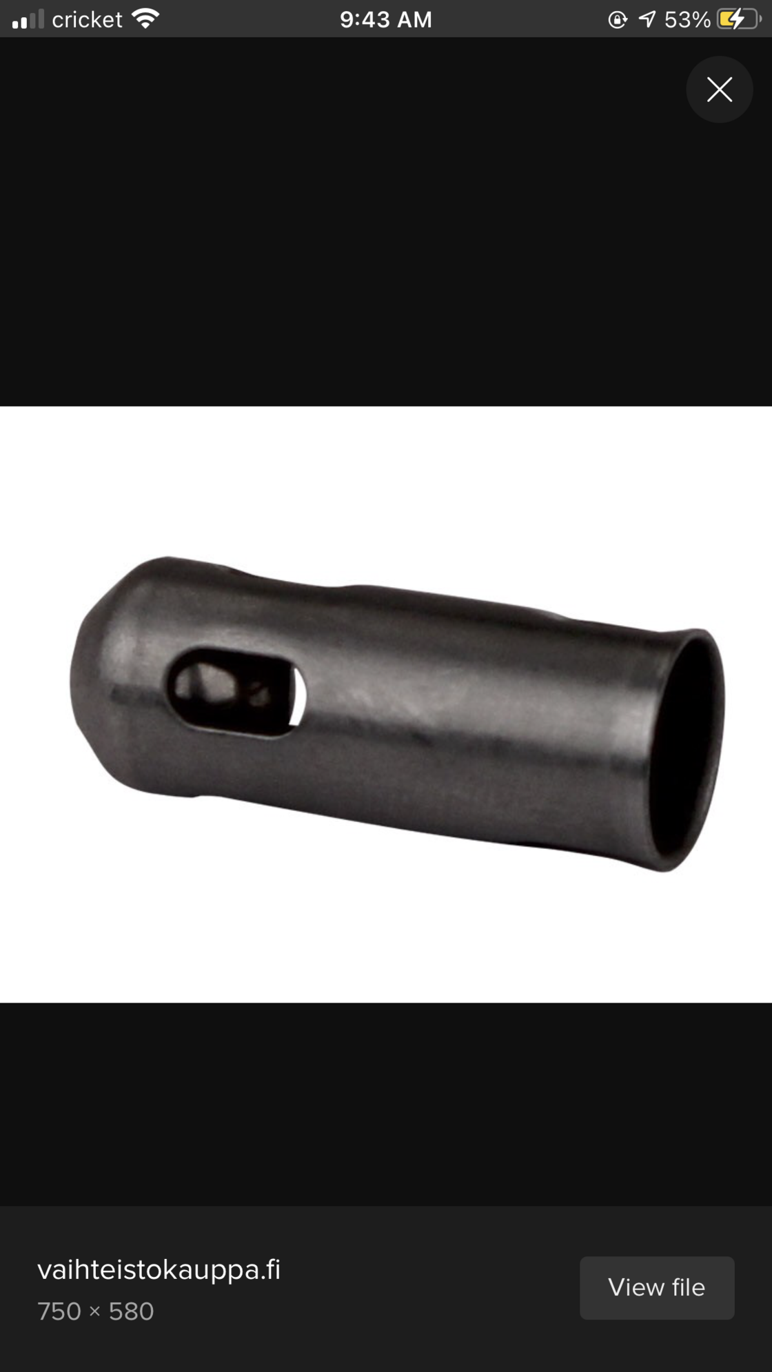

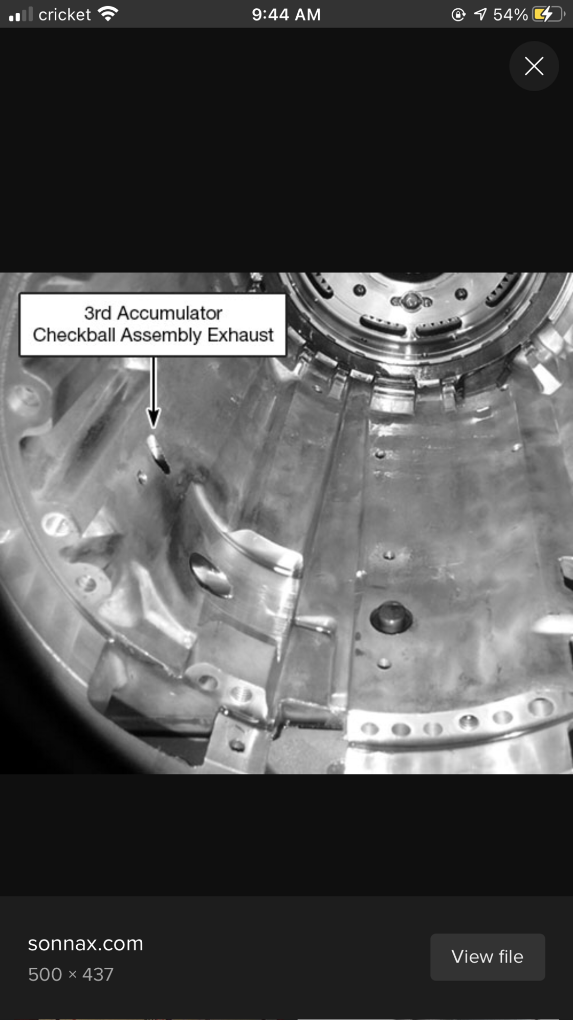

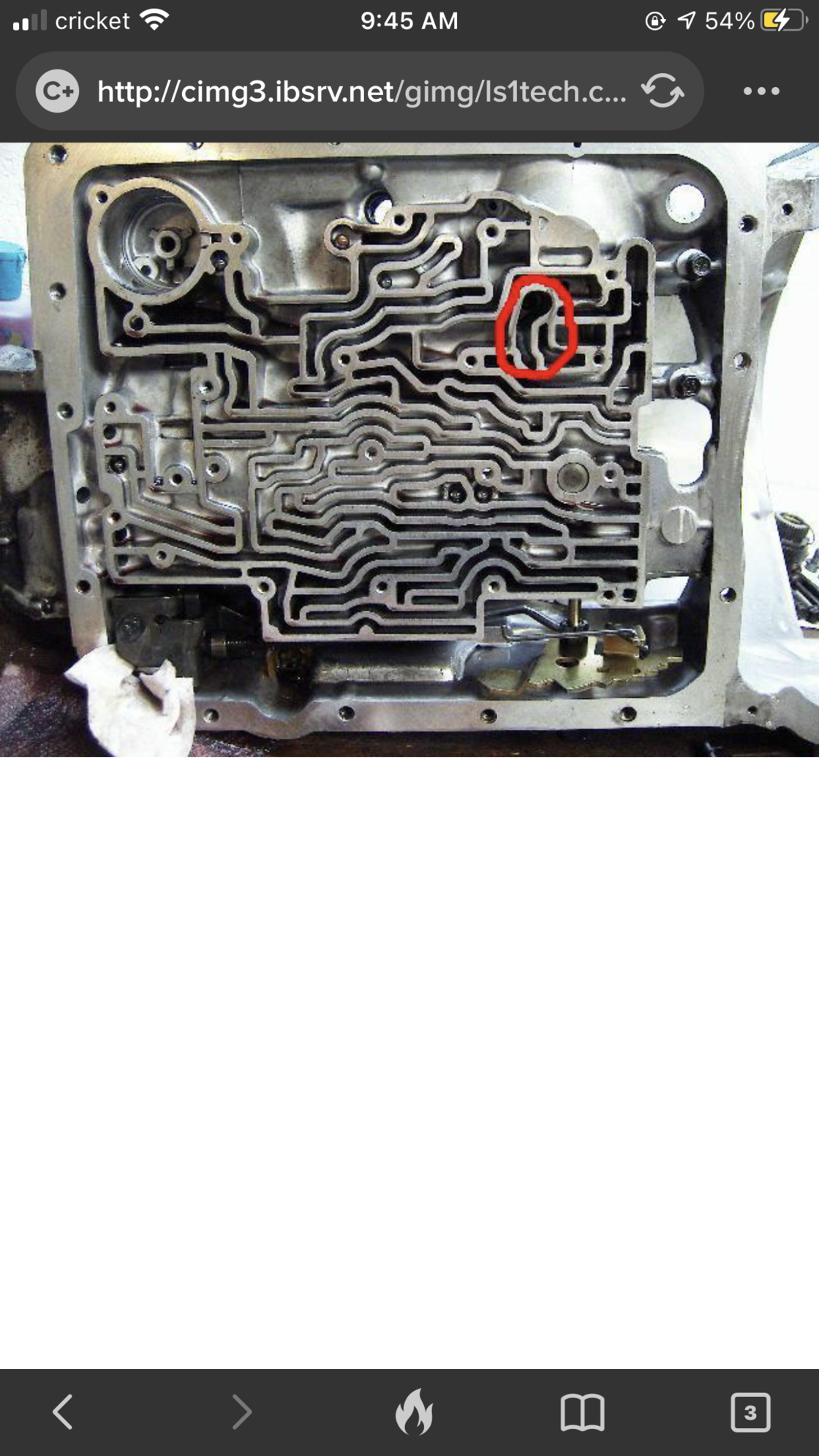

I didn’t find a whole lot of information on why this could have happened, until finally during reassembly I saw that the 3rd accumulator encapsulated checkball was removed and in its place was a plug.
the 3rd accumulator checkball to my understanding is what releases the 2-4 band and allows some type of venting.
I ordered one as it did not come in the master rebuild kit and finished reassembly of the transmission. Also, there was, if I recall, ZERO information about this encapsulated checkball in the case anywhere in terms of professional publications, only one or two videos that mentioned it online and a few mentions on some forums, and the Sonnax website has some theory behind it.
Finally, I found that at the end I was still having less than Ideal shift points. I measured line pressure, but it still felt like something was off, even with the Geometry corrector. The WOT downshift was not happening like it should from the factory, I was also having issues with the cable actually pulling the bracket back and out of adjustment during WOT. The typical holley bracket flange where it mates to the carb baseplate doesn’t really hold onto anything and its not very rigid so it can still be moved with enough force. I looked around forever until I found the Bowler Transmission setup. I bit the bullet, took a chance, & I installed the BT tru-shift kit and this kit although expensive, mimics the factory throttle radius arc required perfectly, and it was a one and done thing, just like all the publications said how to set the factory tv cable, this worked exactly like it should have and the setup is RIGID. WOT shifts are just like factory and drives like a normal car. There is no question this is the way to go with a 700R4/4L60.

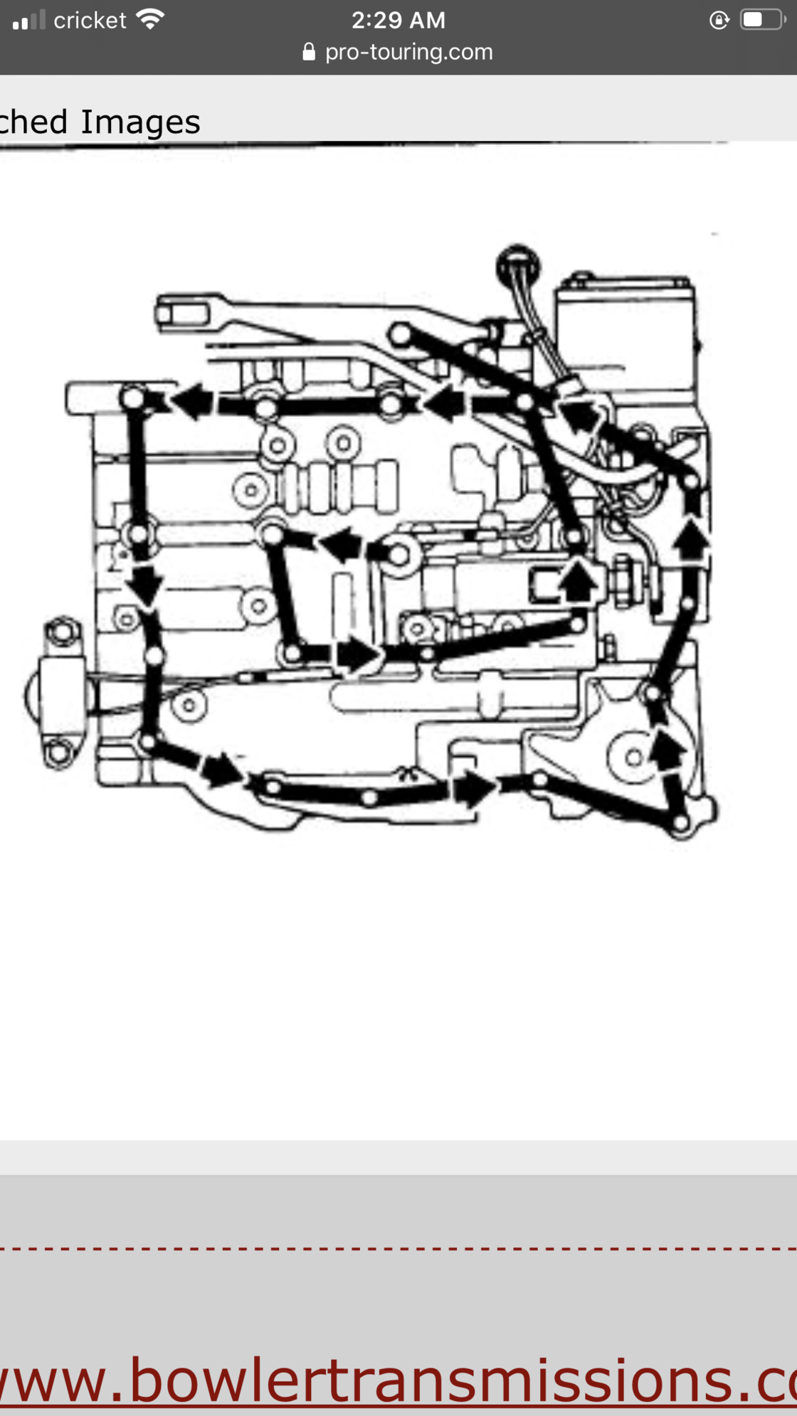

Moral of the story is DONT FORGET TO REPLACE / CHECK 3rd accumulator check ball in the case. It is amazing to me that they still sell the holley 700r4 bracket and geometry corrector because to my math it is still not acceptable or near the range of the factory setup — the Bowler Transmission tru shift is entirely worth every penny and finally the Monster rebuild kit is OK, but if there are other options I’d look into them.

Removing the 3rd accumulator check-ball capsule was a common thing that transmission shops did in the 1980s and early 1990s...
It has been considered to be a BIG NO-NO for the last 25 years!

Buy/ download a copy of the ATSG manual for the THM700-R4...
It will go over the third accumulator check-ball capsule and everything else in the transmission.

Yeah I looked into the ATSG manual, during the rebuild. The amount of information was frankly overwhelming but I did my best to try to locate the information regarding that checkball. Also, I am not surprised that it was something that was done in the 80’s and 90’s.... sounds about right....
