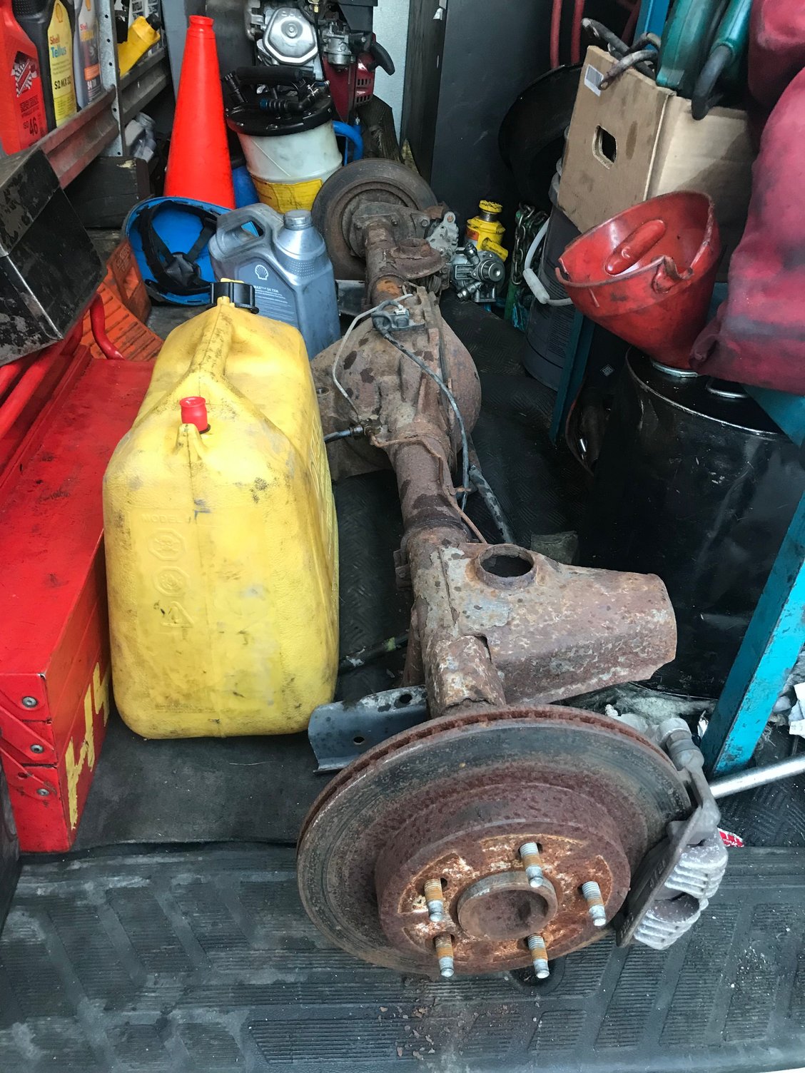

Being something of a novice in the thirdgen world, I didn’t take much notice of the details on this axle, I was pumped for posi, 3.42 gear and disc brakes.
speaking of brakes, those rotors seem large…
11.5” diameter. is it a G80 1LE axle?

No; it's a 93-97 4th gen. The disc brakes used on those are essentially the same as the 89-92 3rd gen ones. 98-up also got the parking brake that is a mini drum setup inside the center of the rotor. Yours of course won't have that.
Housing prep: remove EVERY PIECE from it. Take pictures if necessary. Brakes, brake lines, axle bearings & seals, pinion & carrier bearings & seals, vent, ABS sensor (you can do away with that altogether of course), old control arm nubs, etc. Clean it up CLEAN at the quarter car wash with engine degreaser, a wire brush, and something to swab out the axle tubes. Or maybe even, have it tanked. Take it to someone who can weld on cast-iron; not that that's "hard" or whatever in and of itself, just, they need some sort of oven to heat the pumpkin up uniformly and evenly to at least brown-hot. Have them straighten the housing (rod inserted through it, maybe using something like those "puck" things wheel balancers use) PERFECTLY straight, and weld all the way around the axle tubes, and fill in the plug welds the factory used so that they stop leaking. (looks like both of them you can see in the wide photo leeeeeek) Have it sandblasted. When I did this to mine, I got it powder-coated; you could use that, paint, ceramic, or whatever peels your banana.
Awesome, thanks Sofa. There’s obvious signs of seeping at the seals etc, it does need some attention. It measures 64 1/4” inside of flange to inside of flange.
I’m wondering if I’d be happier with a 3rd gen housing and axles? There is a 91 drum axle at the same pick n pull… I plan to run ‘90 formula 16” rims, 5/8” positive offset for the rears. Either way I’ll gut the housing and drag it to our commercial truck shop, take it for a spin in the hotsy if they’ll allow it. If not the heated power washer does nice work too.
