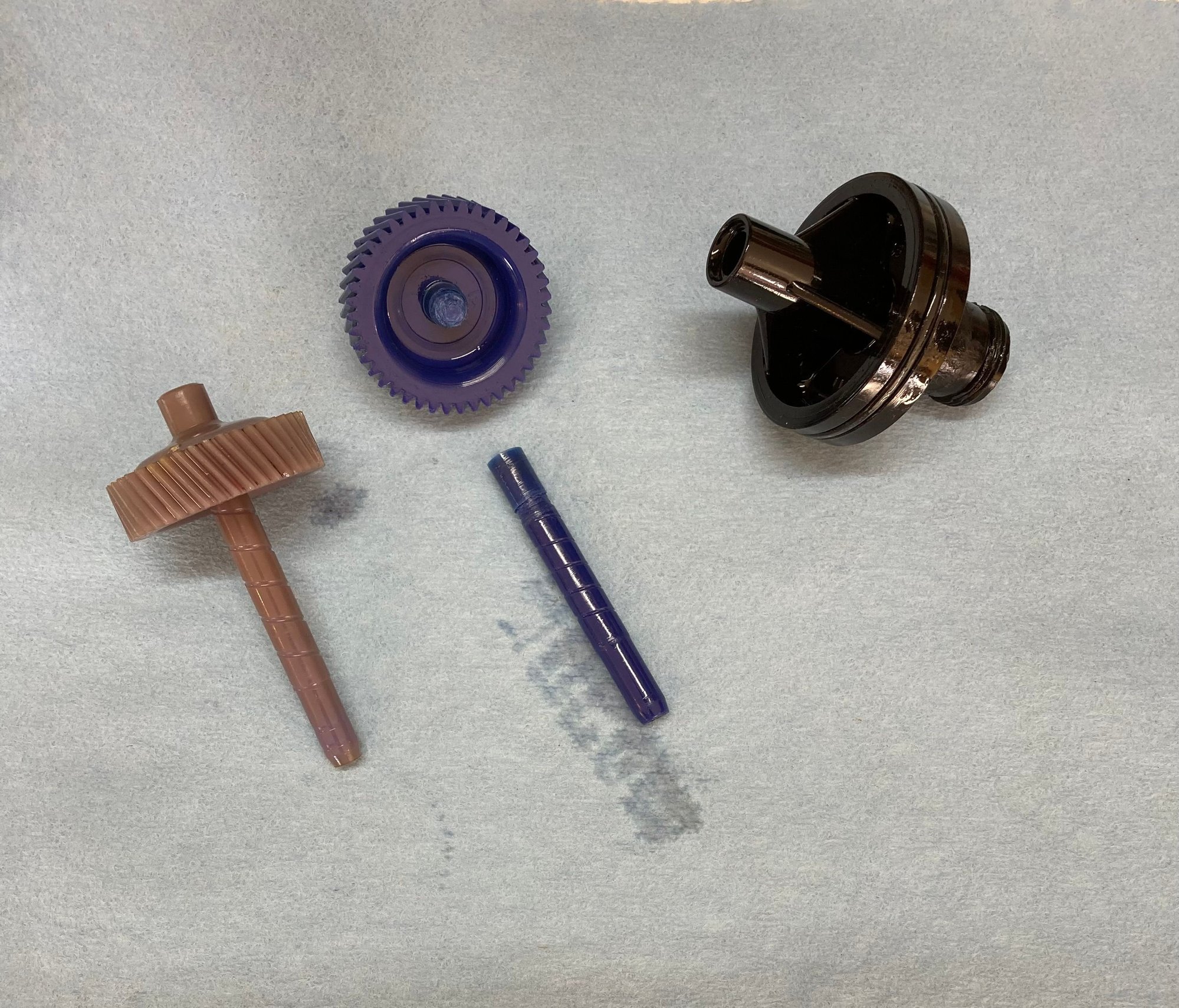

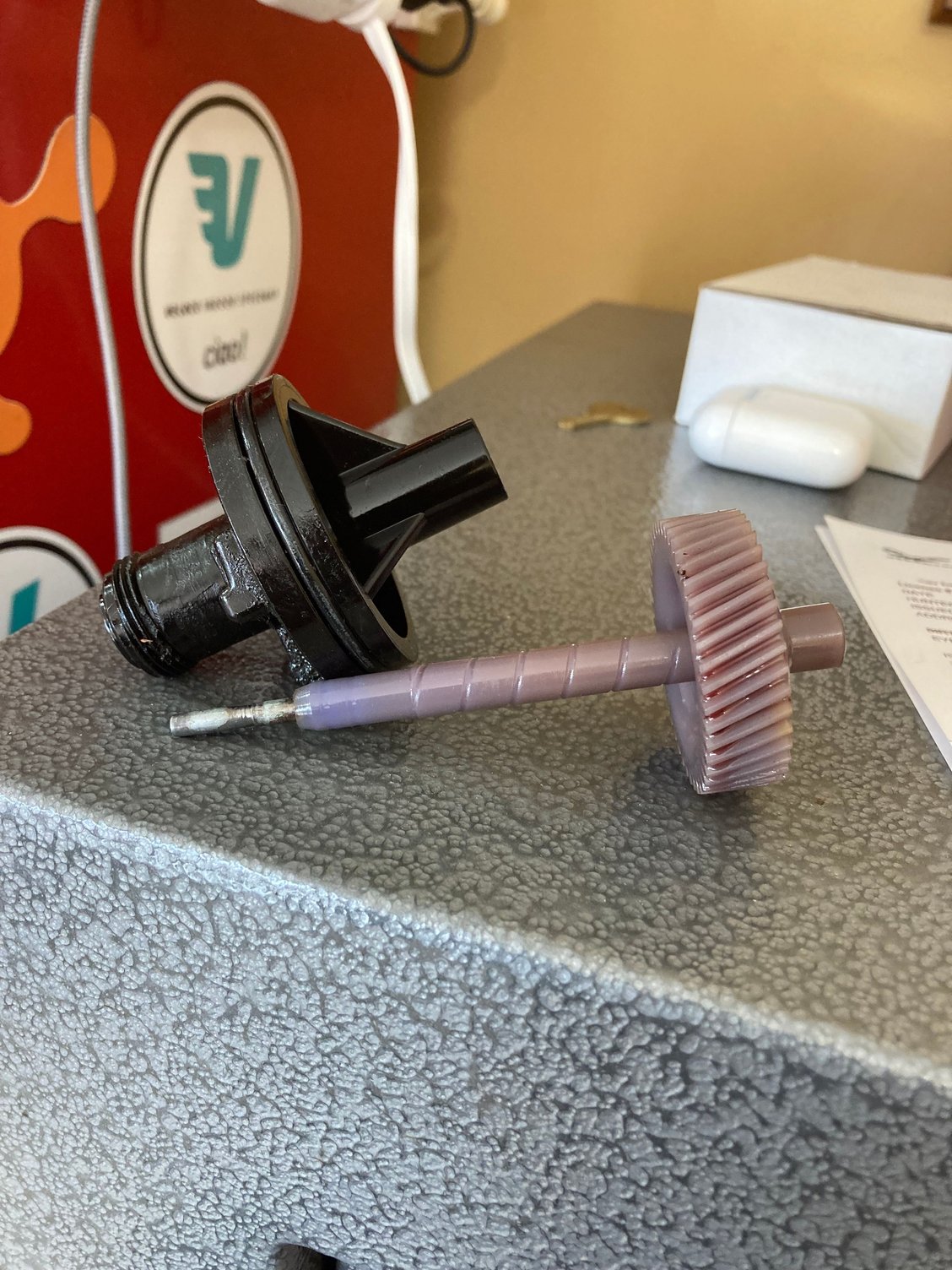

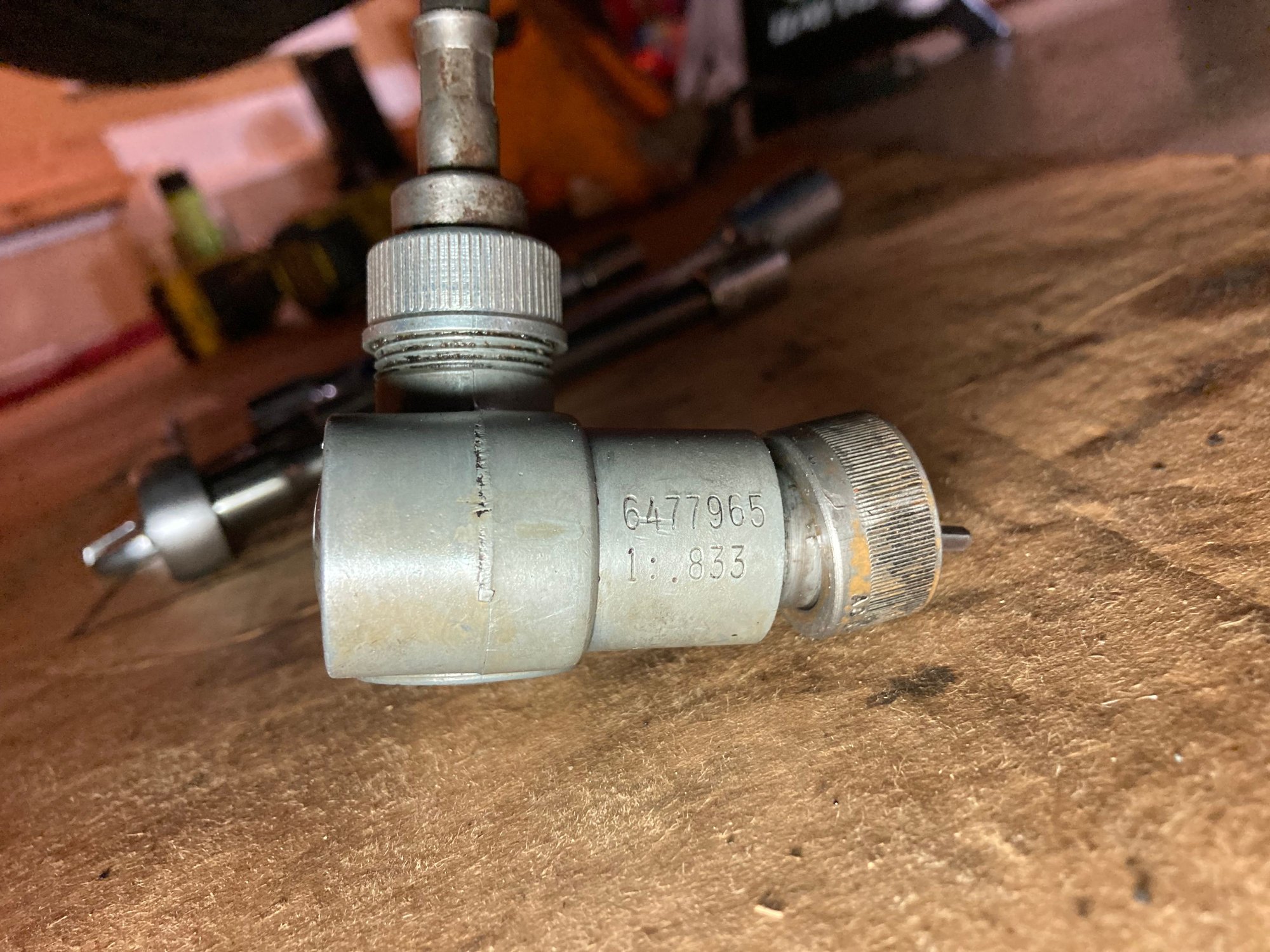

The rear has 3.73 gears. The speedometer housing also has a right angle adapter with a .833 reduction. The speedometer was calibrated correctly before transmission swap. Before I put the replacement trans in the car the builder swapped the drive gear from my core and then I replaced the driven gear with a duplicate. I saved the old driven gear. I may put it back in with new seal and see if it leaks. That’s assuming the drive gear looks fine.
Old driven gear
Right angle adapter

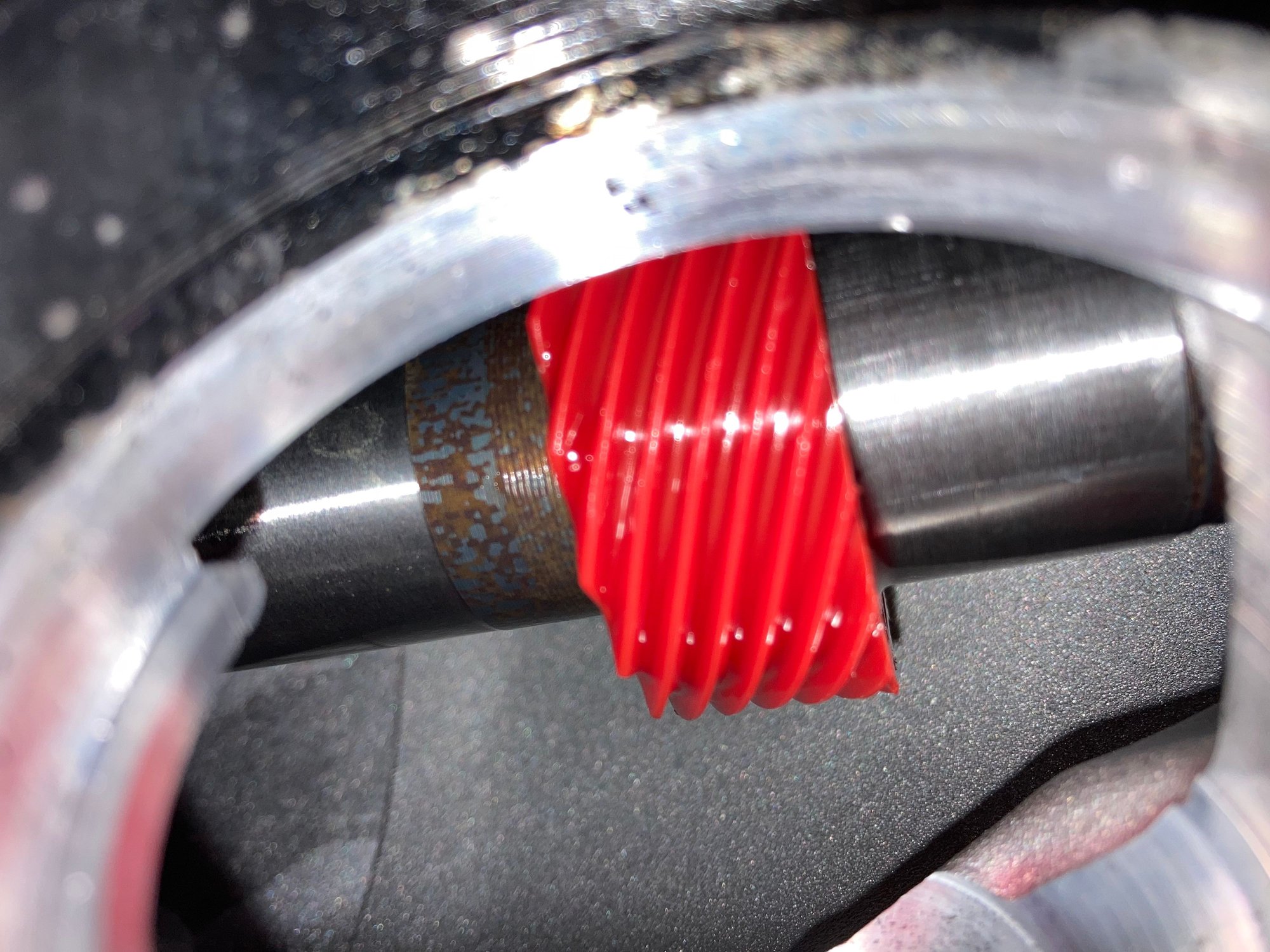

Mystery solved! Hopefully just an inferior aftermarket part or manufacturing defect. Guess I will put the old one back in and see if the new seal holds. There were some grooves worn in the old shaft. Drive gear on tail shaft looked fine thru 360 degree of rotation. BTW, I jacked the rear up about 3-4 degrees over the front and barely any fluid was lost.

A brand new gear snapping makes me think you may have a bind of the speedo, cable, or adapter. Any electric drill can overcome friction that can kill a speedo gear. I didn't see you post tire size, but if a ratio adapter can be eliminated, it's usually a good thing.

I know the right angle adapter is smooth as silk, not sure about cable or Autometer speedo gauge but I understand your point regarding the cordless drill.
Can't remember the tire size but if I changed the driven gear to eliminate the right angle adapter I would also have to replace the cable as it would not be long enough. Car does not have cruise.
