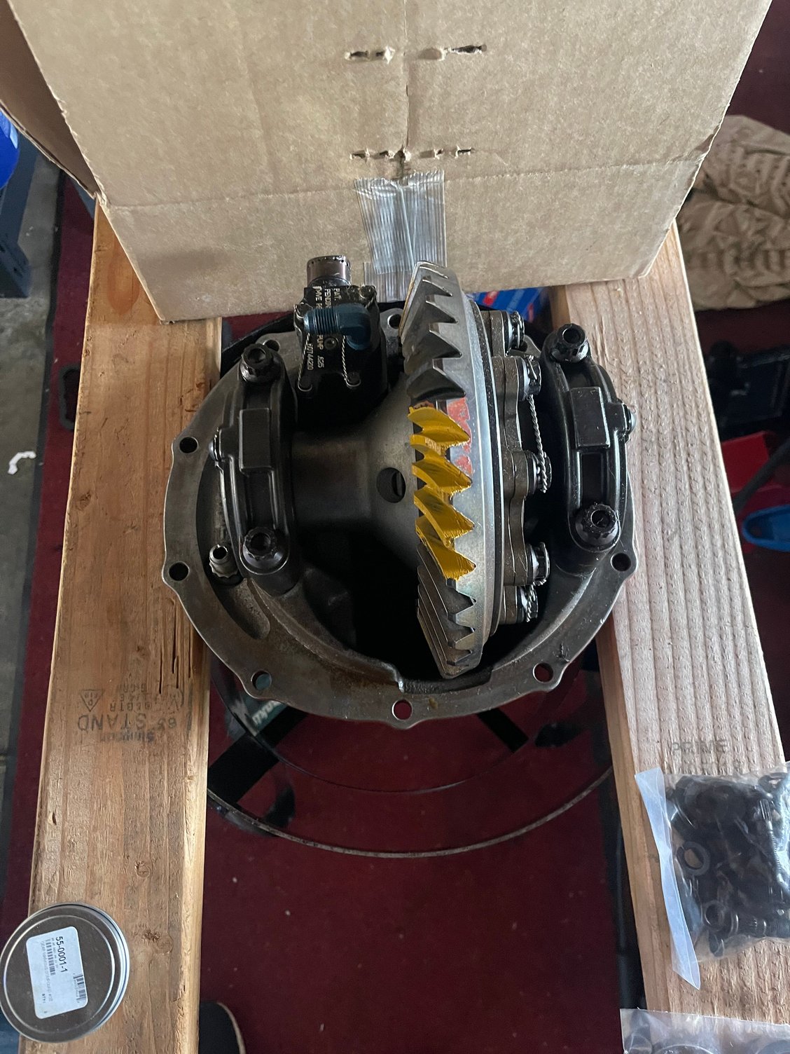

Hello all,
can someone please tell me what limited slip I have and the oil needed. Thanks in advance.
I was thinking Detroit locker but I’m iffy on it at best.

I have not seen one in a long time...
But that looks to be an Air Locker/ Pneumatic Locking Ford 9" Diff.
Not a Limited Slip Diff.

Looks like it has a internal oil pump for a external oil cooler. Used to use those on the panoz road race car. Nascar used them too.
Ford 9 Inch Internal Oil Pump Option | GearFX (gearfxdriveline.com)

yes, it’s a pump.
The guy I got it from said it’s a nascar unit. I had to make that hardline to connect the pump to the case so that I can use it with a cooler down the road.
should I put modifiers with the non synthetic fluid? Thanks.

It's probably a Detroit locker as is apparently a stock car takeoff. It's probably also a stupid low gear, so it may not be very useful to you.

Looks like this to me.
Ford 9 Inch Eaton Detroit Locker 31 Spline – Light Weight Racing Version | GearFX (gearfxdriveline.com)

You’re right… looks just like that one.
the ratio is 4.00
so do people add friction modifiers to those or do they just run them with non synthetic oil?

Yes. I use posi lube & non-synthetic oil in my 1972 Buick gs which had an Eaton positraction unit. that I sold 2 months ago. Never use synthetic!

Detroit Locker has no clutches. So no need for friction modifier. Synthetic or non-synthetic is up to you.
