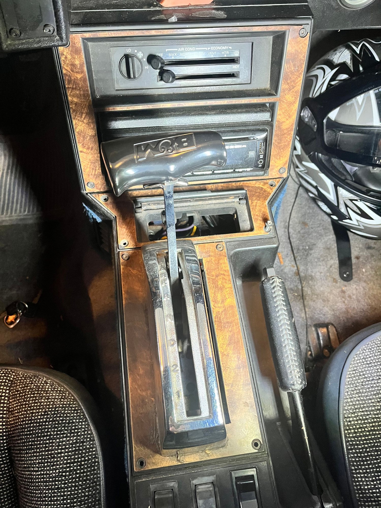

Hell all. I'm looking for some help with a B&M shifter that is being used on a 700r4 tranny. Im not exactly sure which shifter this truly is? You can also see from the picture that the gear selector only shows 3 speed. The 700r4 is a four speed transmission. This was they way it came when i got the car!! my question is does anyone know what kind of B&M shifter this is and where i can buy the proper gear selector for this shifter? Thanks

How does it shift? Like a normal shifter or more like a ratchet ?

This does shift like a normal shifter

Get that shifter out of there and buy the correct one. Looks like someone installed some kind of universal shifter that doesn’t fit right at all. You need this B&M megashifter made specifically for thirdgens. It will come with two indicator windows - one for a 3 speed and one for a 4 speed:

That's what i was thinking was going to have to happen. Are these units hard to install?

I found the hardest part was getting under the car to route the cable and then adjust it to make sure it goes through all the gears properly. I think there’s instructions at the link I posted above so you can see what’s involved.

Are you sure you still have a 700R4? Maybe somebody installed a TH350 and needed a new shifter to match?

The carb still has the detent cable connected to it. So i gotta believe this is a 700r4.

THM350s have a Detent Cable.
THM700-R4s have a Throttle Valve Cable (improper use of this cable will burn up the Transmission).

That's a B&M Z-Gate shifter. I had on in my Camaro. They now sell a 4 speed version but when I bought mine, they only had a 3 speed version. The instructions said you could install it on a 4 speed but you wouldn't be able to manually shift it to 1st. I modified it by cutting another notch for first gear. I didn't use the chrome cover but you would have to extend the opening another inch rearward. If you want pictures I could dig the shifter out of my garage. I really liked the shifter. Way better than the stock shifter or a ratchet shifter.
