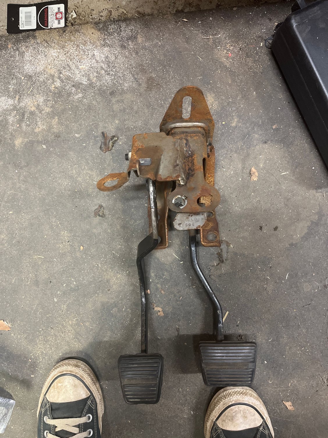

Looking to do a manual swap to my 90 IROC.
Found these pedal options F.S.
Told both are for 82-92 but they are different.
Also what else should I be looking for that can't be purchased new?

The left one is from 82-83 mechanical linkage. The right one is for hydraulic.

Should have done more searching before I posted.
See Hawks is selling new pedal assemblies.
Thanks for your time

The one on the left isn't from a mechanical linkage. It's a bastardized auto setup, stay away from that.
this is a mechanical linkage setup.

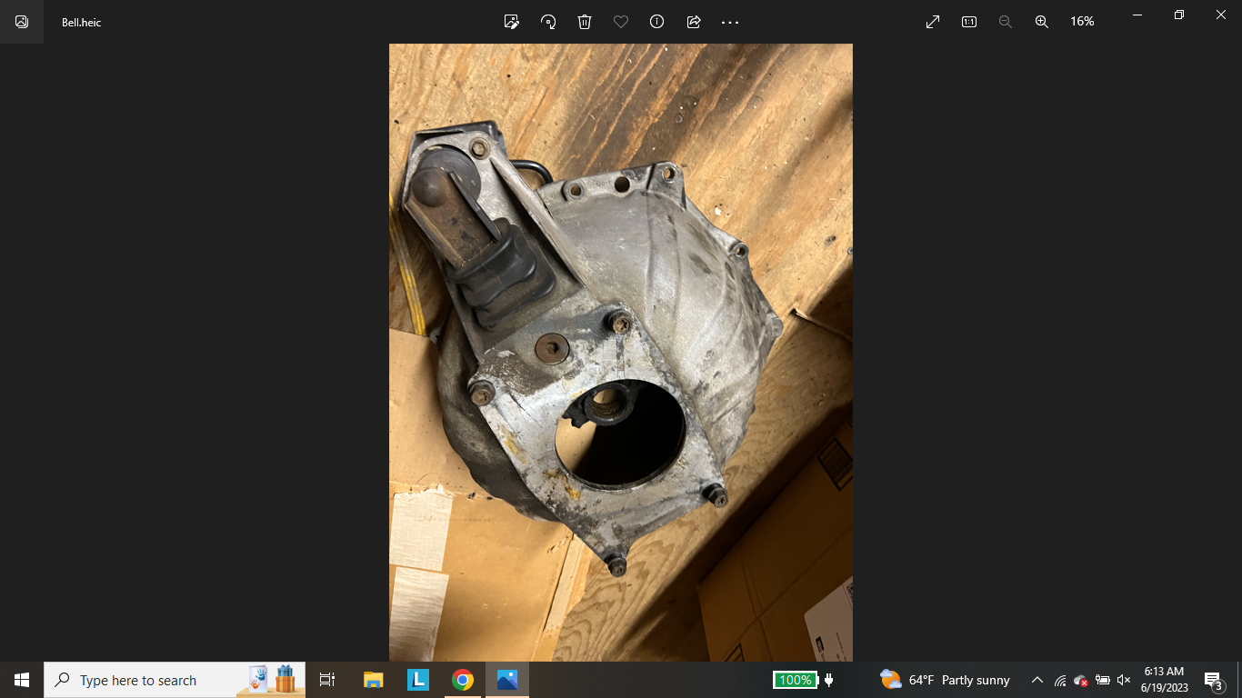

The same person says he has this bell housing.
What is this from ?

That looks like an 84-92 bell.

Yup, 84-92 V8.

So this would be for a T5 ?
yes
