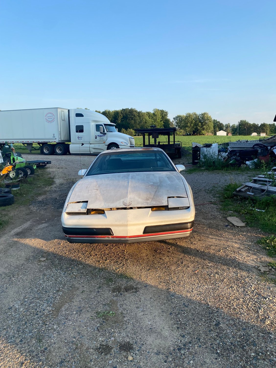

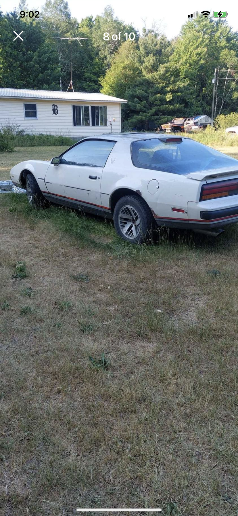

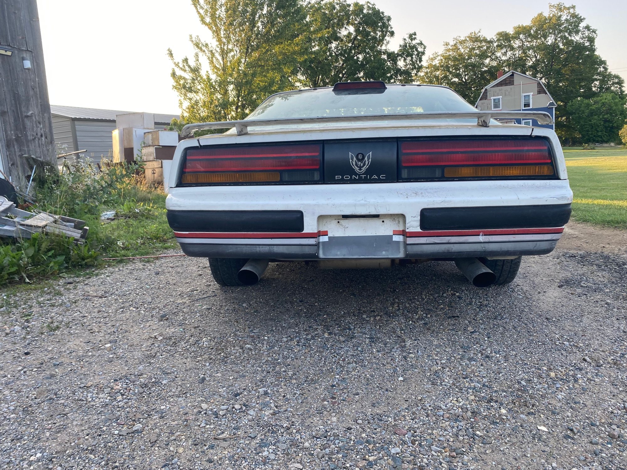

Hello firebird and Camaro fans.
About 7 weeks ago I bought a 1986 Firebird base model that had been sitting for a while, and the dude I bought it from had swapped the 327 that was in there for a carbureted 350, mild build, roller cam. It has some 3 speed auto transmission, was going to be a drag car before I bought it. No heat or A/C. Now my problem is that I bought a nice set of rims and some staggered tires for it which fit nicely onto the car, however they are the wrong bolt pattern. The rims are 5x4.75 and the car is 5x4.5. Everywhere I’ve looked I’ve seen that firebirds and Camaros all have the same small GM bolt pattern, 5x4.75. Am I wrong? Were the axles swapped? Idk. I can buy adapters with a 1 inch space, it’s not a problem, but are all firebirds and Camaros 5x4.5?
anyway here’s the main problem. My dumbass cousins drive the car when I’m not home, and while doing a burnout on the crappy tires that are on it for now, they noticed that the rear brakes just weren’t there (front brakes weak as well but don’t worry about that). Now the rear brakes are drums, and the rear axle is an open diff. And since I want to street race the car, I originally wanted to at some point swap a Posi rear end with better gearing. Can I kill both birds with one stone? I found a Posi rear end from a late 4th gen Trans Am (3.43 gears) with disc brakes. I understand I’d need some conversion kit to make those brakes work on this older car, but how hard is it to bolt that rear end in?
another Reason I want to swap the rear axle is because it leaks fluid constantly. Lol. I don’t want to spend some $3,000 on a Hawks rear end because I am broke and this isn’t my only car, but I would like to know if the rear axle swap is possible. Thank you all very much, have a blessed day.
