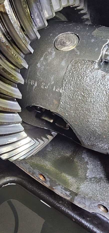

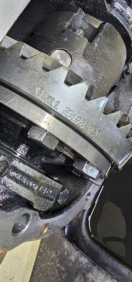

What kind of carrier do i have?
I know that its a 3.73. Anything else from the rest of the numbers?
Came out of a 92 camaro z28 all info i have.

Looks like a stock (Auburn) 2-series with the "thick" 3.73 gears on it.
