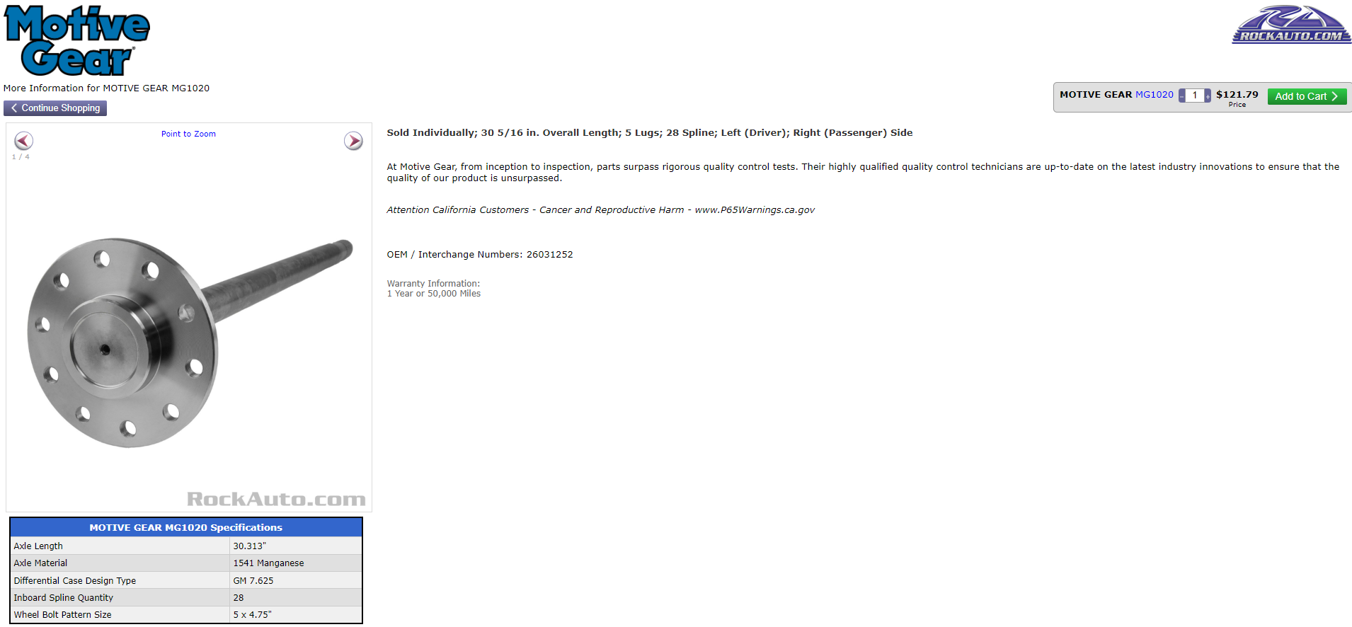

I installed the Motive Gear axle shafts part number (MG1020) in my 10 bolt from RockAuto. They don't list the wheel stud size, but I ended up ordering 1/2-20 wheel studs and installed them as they fit. You can either go with threaded or press in, I opted to give the wheel bolts a try.
My axle housing is from a 1985 Firebird, the guts are from a 2002 Camaro 10 bolt, I ordered the 28 spline axle shafts from RockAuto for a 1991 Camaro. After having the axle rebuilt, it is in the car with no issues.

Just seeing if anyone has installed the Motive Gear axle shafts in their 10 bolt. I can not find the wheel stud size for these axle shafts as I was assuming that I could use factory studs but they don't fit and Yes I can go measure, but seeing if anyone else has already done it and what they used.
Looks like they take a 1/2-20 wheel stud.
The motive gear axles in the pic say they take a 12mm press in wheel stud. They are 28 spline for a 3rd gen

They don't fit, I assumed they were 12mm as well, Also that comes up as a different part number than the ones I have.
That part number is for a 91 Z28. Your op has zero info in it. You don't mention what year or anything. Some of us are still working on mind reading abilities

They take a 1/2-20 wheel stud.
