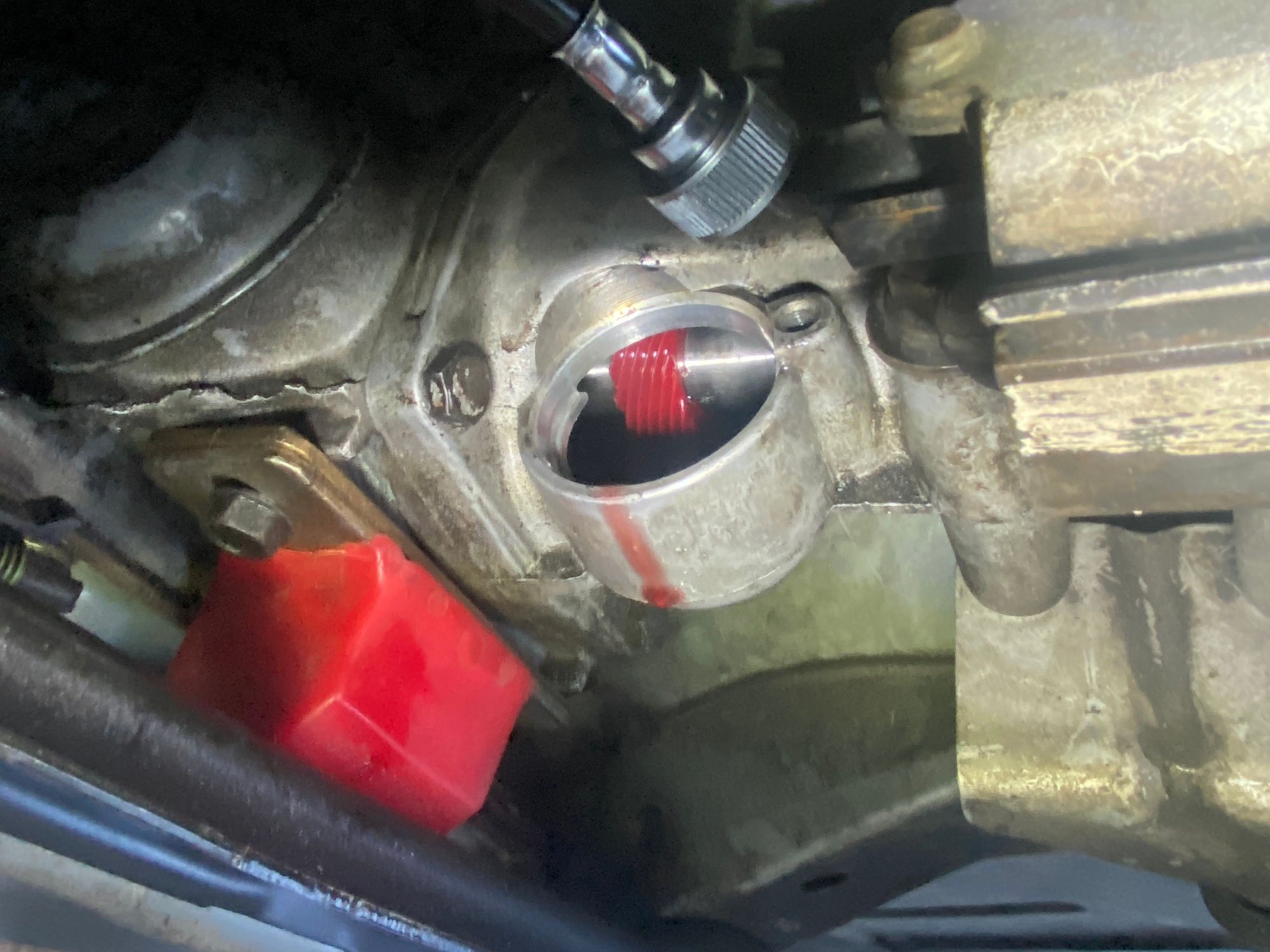

If anyone happens to catch it in the photo, I am aware that my drive gear on the trans is missing the clip. I am midway through working that out on another post, as its Its the cause of my no speedo! Which leads me to this question so I can fix this all once and for all.

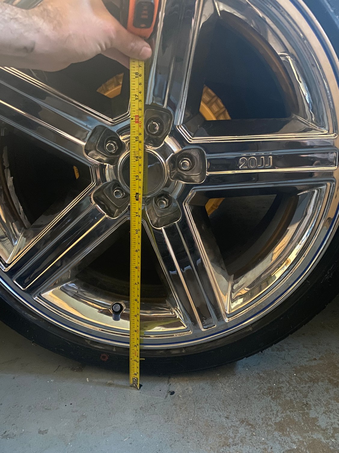

I have 255/35/R20 rear tires. The measurement from the ground to the middle of the wheel is 13.5 inches. The tire is 27" top to bottom.
My transmission has a RED 17 tooth drive gear
I should require a 34.63 tooth, which rounded up for safety( right?) puts me at a 35 tooth gear which is orange.
Is this combination correct?
