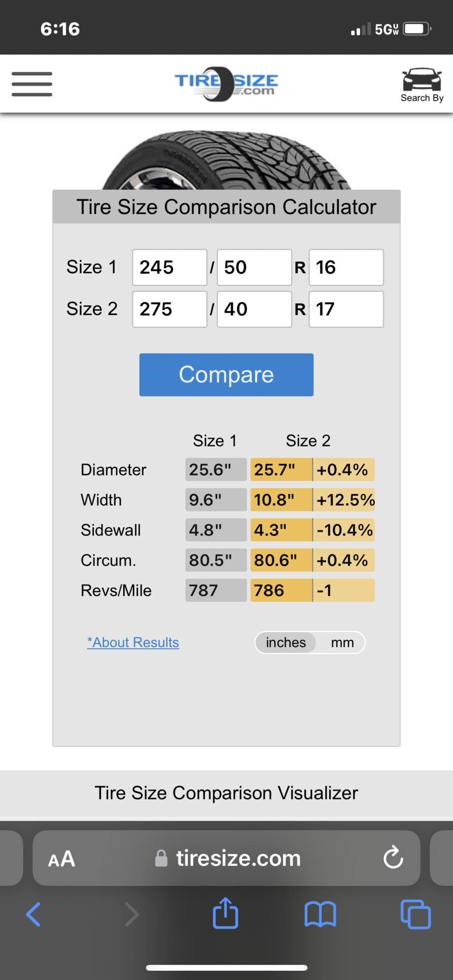

700R4 original to 1991 LO3 305TBI with a 120mph speedo, car originally came with a 3.08 up diff rear end.
current rear Borg Warner 9 bolt with a 3.27 gear
Rear tire size 275/40/17 25.7"-inch-tall tire which is the same height as a 245/50/16 OEM Trans AM and Z-28 tires.
Help me understand Rear gear change speedo-gear correction and what gears I need

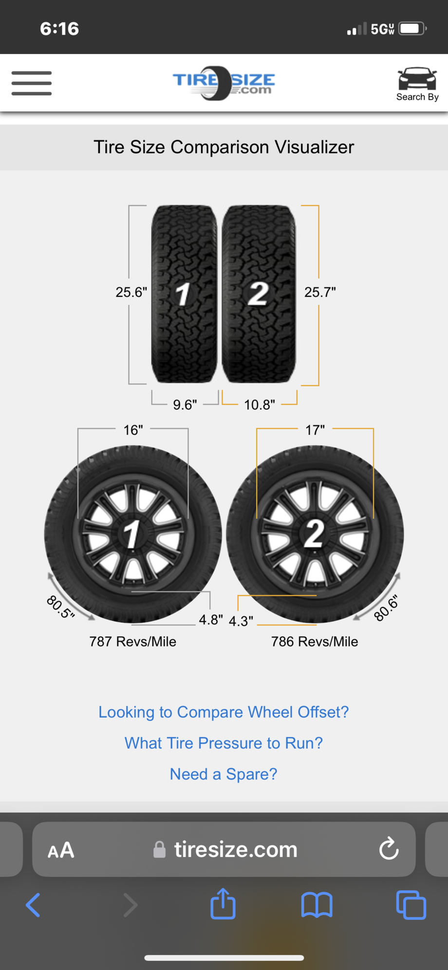

A 275/40/17 and factory size 245/50/16 are both supposed to be 25.7” tall at least that’s what the trade numbers say.

Ignore the "trade size". It is, at best, an approximation. Your car's weight, the pressure you run in your tires, the temperature that they reach while driving, etc., will ALL affect the ACTUAL size that the tire presents to the outside world. What you need to be concerned about is the RADIUS from the center of the wheel to the Earth, NOT the "diameter" shown in the "catalog".
Use a tape measure on YOUR tires when installed on YOUR car.

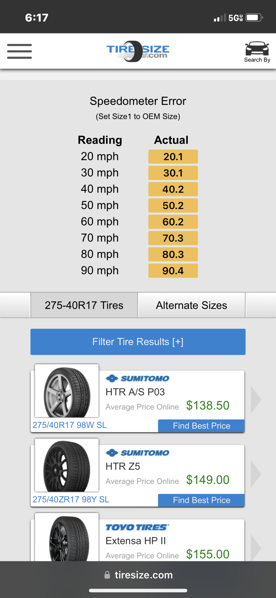

275/40-17 is equivalent height to stock for all practical purposes. There is variation from brand to brand, model to model, worn versus new. That's all noise in life, just ignore it. Speedometer is not accurate through the range anyway. Best you can do is choose a speed you want to know is accurate and the rest of the range is what it is.
Why even bother with tape measures? You have a driving car so get straight to reality and go for a drive at the speed you want to be accurate and calculate the percent change needed in speedo reading. Snag the gear ratios that get you that percent change of speedo reading. (You have to know your current speedo gear set to make that calculation.)
I calibrate my speedo with a laptop but it's the same concept whether using keyboard or gear ratios. I like my speedo to be accurate at 60 mph so I drive at 60 mph by GPS and read my speedo. If speedo is reading 70 mph, then percent change needed to correct speedo is, [(60 GPS) - (70 speedo)] / (70 speedo) = (-14.3%)
