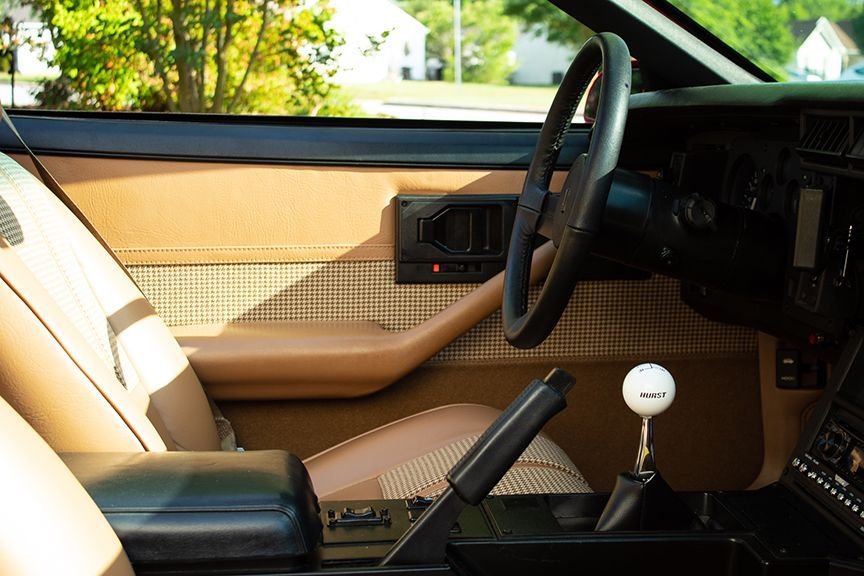

Here's the lever on the Pro 5.0 It's about 1.5" taller than the Pro 5.0 lever, plus looks nicer!

Cool and great idea. Thing is still far from the steering wheel, could be b/c of the camera angle and what gear it's in.

This one is in neutral.
