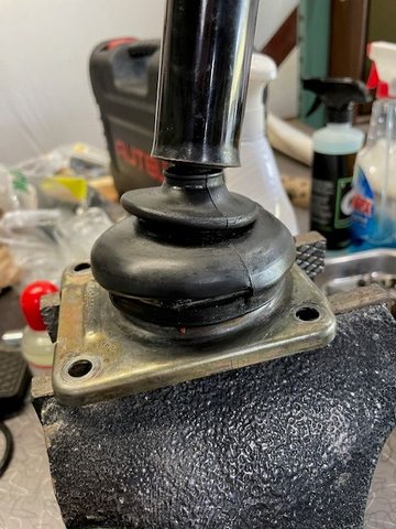

While I have the interior out of our 92 Camaro, I discovered that the rubber boot for the shifter was torn, and apparently leaking. I'd like to replace that, if possible. Has anyone done it, and how does it get done? It looks like the shifter is swedged to the shifter mount plate, so taking it apart is not apparent, nor does it look easy. I have found a T5 'rubber' on some web site that supplies transmission parts to the S10 crowd. It looks a bit different, but I'm thinking it can be used. Do you 'simply'. stretch the boot over the shifter lever and hope it doesn't rip?
Additionally, anyone have a P/N for the gasket for the shifter mount? It was RTVed on there, but when I was cleaning that mess off, I also had to scrape some gasket material off, so there at least used to be a gasket there. Thanks.

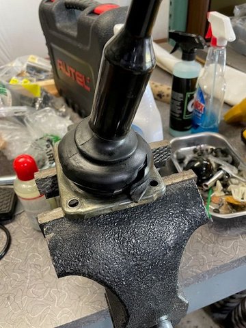

The dust boot from Core Shifters arrived. It slipped over the shifter lever with a little help from silicone grease. All done. I piped some black gasket-maker RTV through a small hole in the provided nozzle and bolted everything down. All done, with this part of the project, anyway.

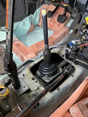

So I gotta ask, what's with the bricks in the footwells?
