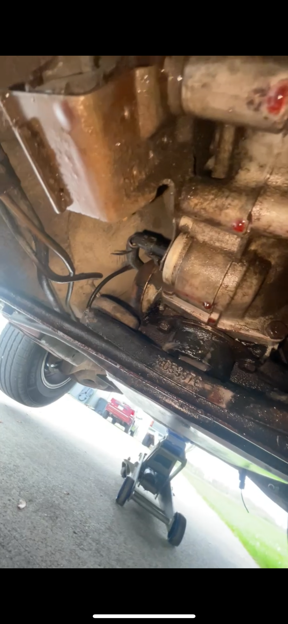

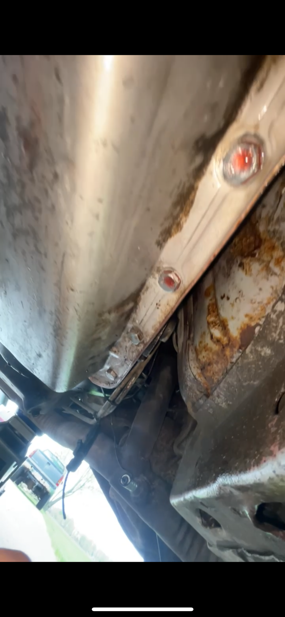

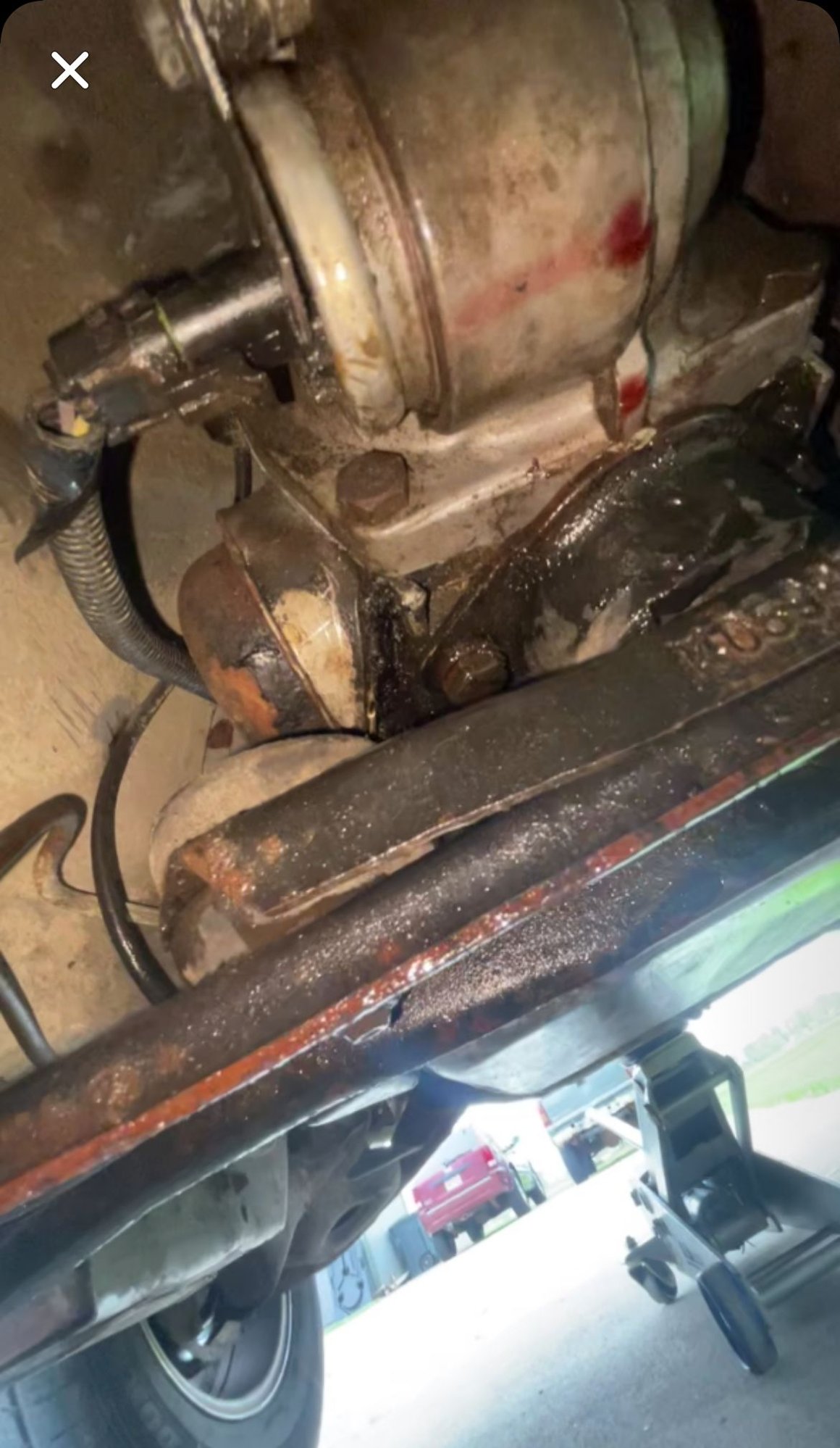

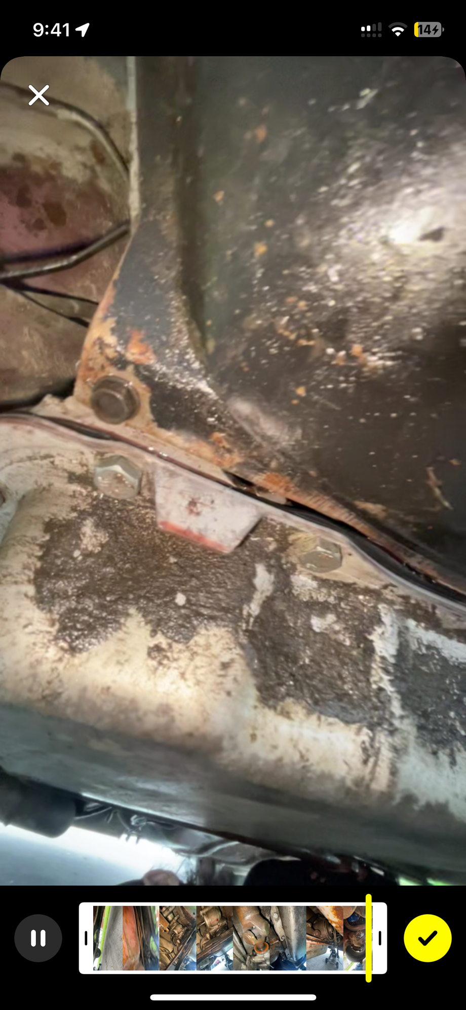

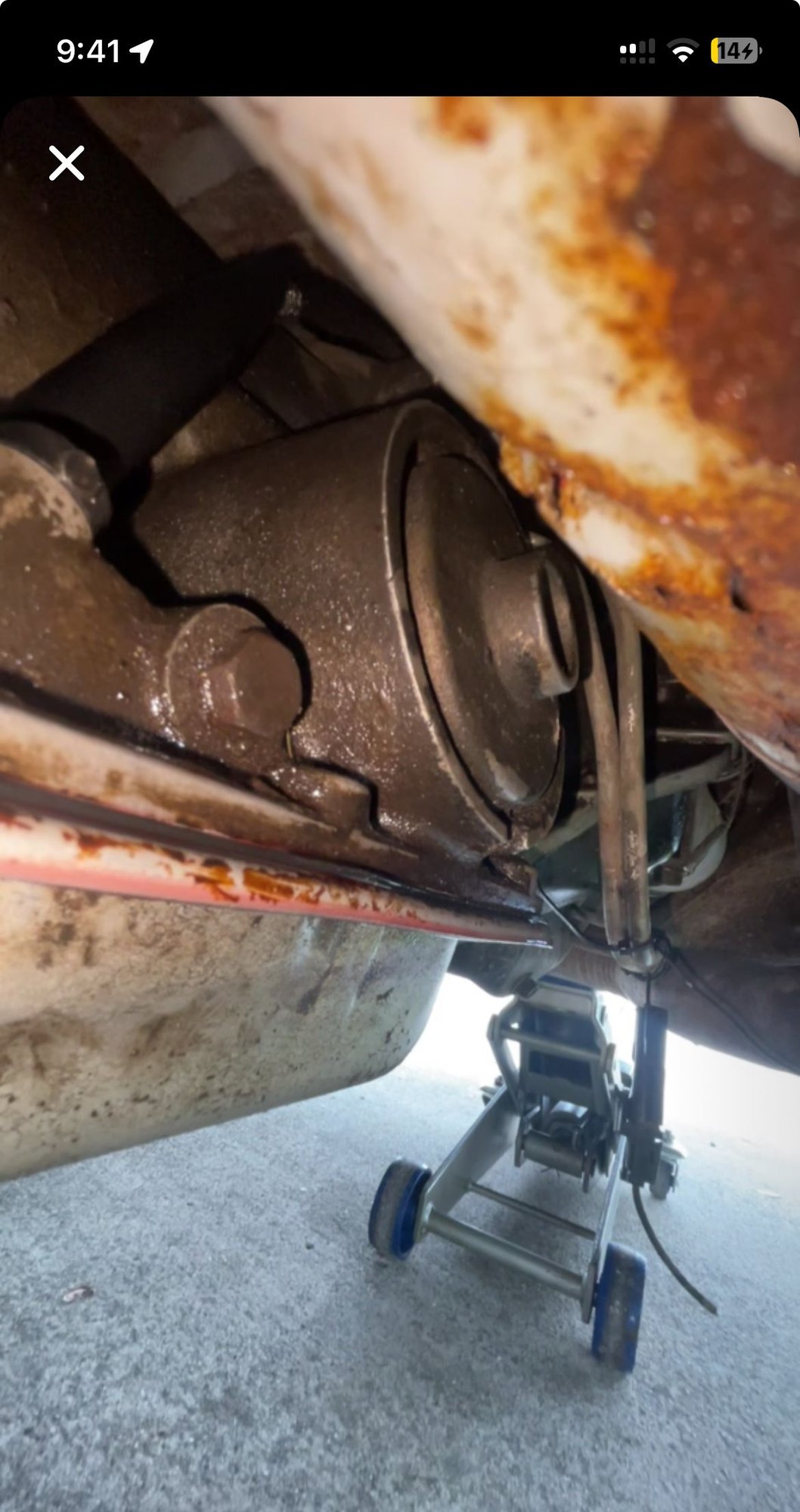

Gonna continue adding to this thread until I’m out of the woods with my transmission stuff.
update as of today:
- 4th gear exists, a TV cable adjustment helped and it goes into 4th on its own no problem
- it is leaking like crazy though and I can’t pinpoint exactly where it’s coming from (I’ll attempt to attach some form of photo/video)
- to add, it seems to be leaking from the pan gasket on the pass side of it, and from where the speedo gear goes (pretty sure thats what it is) but I think I stopped that leak (not sure)
After I looked it over, i loosened some pan bolts, fiddled with gasket, re-tightened, cleaned up area and all fluid under car, when I get home tonight or tomorrow morning I’m gonna look again to see if i can get a more accurate view of where the leak is coming from.
Been brainstorming, if it’s the gasket I’m gonna silicone seal it (or whatever people use in place of gaskets). If it isn’t the gasket I’m not quite sure.
There’s nothing coming from the front where the rear main seal is (another possibility that was talked about in this thread)
Visibly speaking, the leak appears on the gasket, and behind the transmission.
Input always welcomed and appreciated.
pan bolts that have fluid dripping from them
front of trans looking towards back of car (from torque converter cover)
Speedo gear thing (I don’t know what everything’s called, I’m a newbie)
pass side pan bolts again (getting a look of gasket)
repeat photo just larger area
