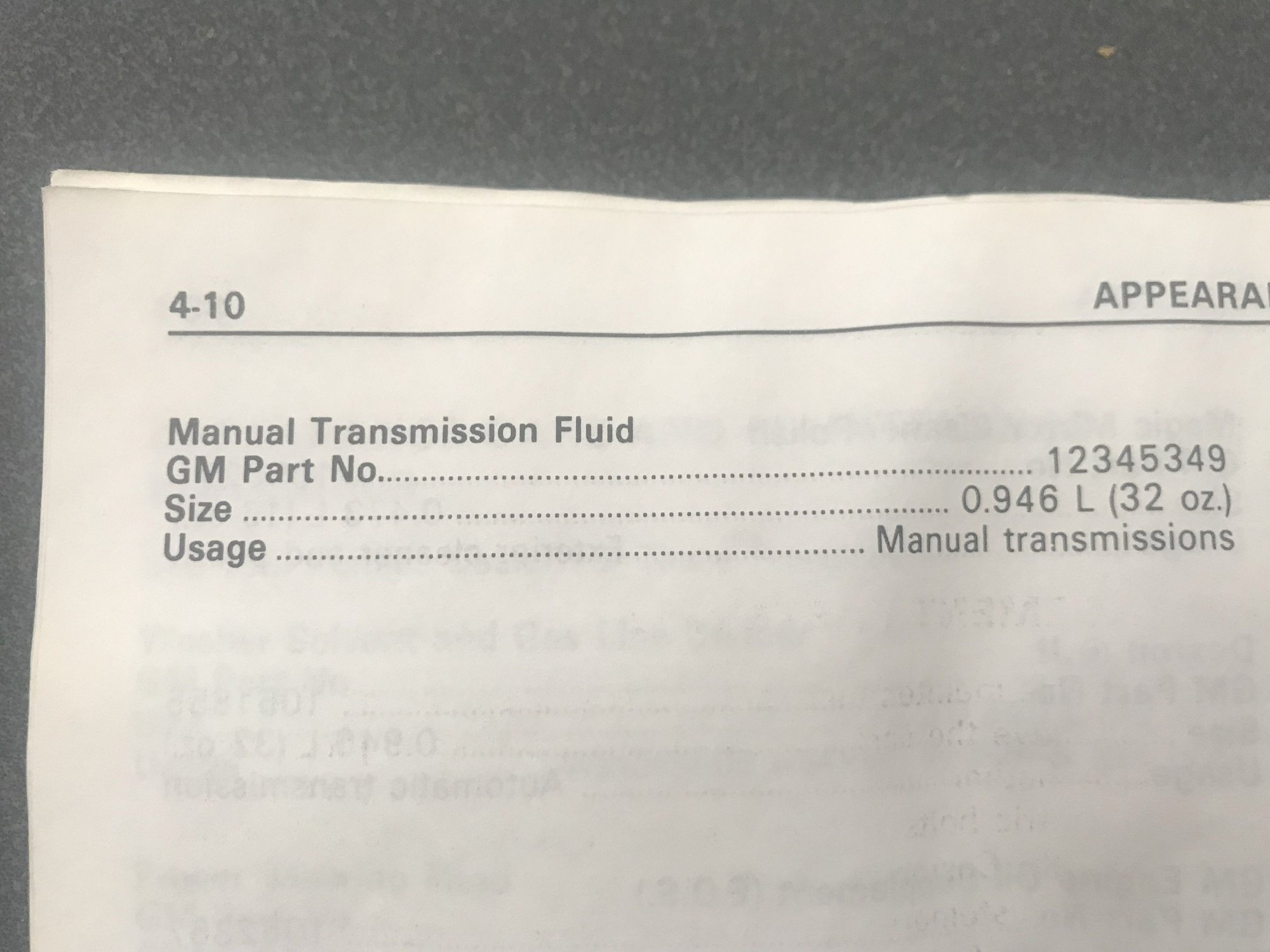

Ok dumb question I'm looking at my owners manual and it says,
I look up the part number and it comes up with, GM Synchromesh transmission fluid on amazon.
GM part No 12345349 GM part No 12345349
All for the low price of 92 bucks a quart. Which makes me guess that the original stuff has been discontinued and that is why you guys are recommending Dexron 3. Or am I missing something here or just way over thinking things? I have found some other brands that say they are the GM part number 12345349 or Syncromesh transmission fluid should I use that or go with Dexron 3? AMSOIL 5W-30 Manual Synchromesh Transmission Fluid is what I am thinking of getting right now. Am I reading that right that if I am changing the fluids I need 32 oz of transmission fluid? Anyways thanks for the help. I got this old Firebird and finally have it to the point where it is running again but I don't know how old all the fluids are or when they were changed last so I am thinking it can't hurt to get all the fluids changed so I just don't have to worry about it.

The year of your transmission does not use gear oil.
It uses automatic transmission fluid (Dexron II/Dexron III...

"Dexron/Mercon" at the parts store. It is Dexron III.
GM 88900333.
No engine oil. No gear oil. Both will cause blocker ring material failure. No Dexron VI. That has too low a coefficient of friction.
Using "heavier" gear oil is thoughtless-think. ATF is completely fine for lubrication. You don't improve lube in a gearbox by using something physically thicker unless the thinner product breaks down at operating temp. ATF doesn't. You DO improve lubrication by using a product that will continually remain fluid, resist aeration, and coat wear parts. ATF does this great. The breakdown of T5 units is largely due the cheap *** bearing design and shaft support at the maindrive/mainshaft piloting which flops 3rd around, and the counter nose with vibrational casting wear. All of which happens with gear oil in early, and with ATF in late units.
