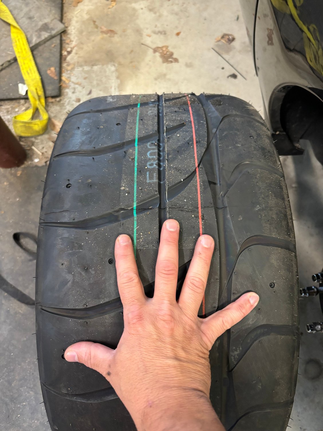

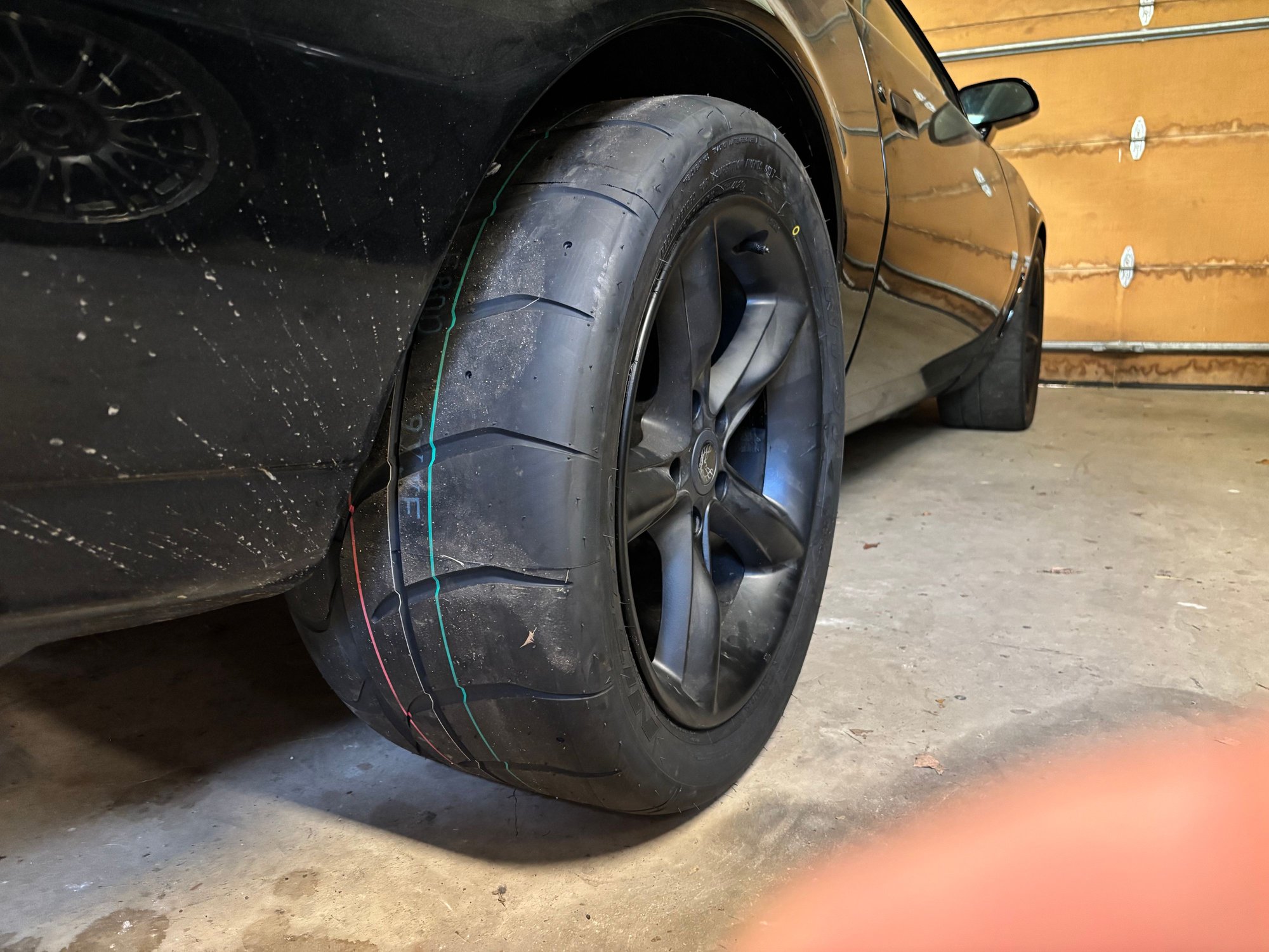

Very nice, I bought the wheels I have now, specifically for my start at autox'ing. I don't plan on buying any other wheels. I have found the strange reality, that while there are less options in the 17" size, which is annoying, for some reason, they're significantly cheaper than the same tire in 18" size. That was part of my consideration...
I did some more paying attention to how the car runs and feels at various rpms. Like cruising at higher speeds in 3rd gear instead of 4th, and I think the 3.73 won't be as bad as I though, plus for the most problematic slow to mid speed driving I do, it will get the rpms into a better range for my engine, so that is now the route I'm planning to go. Only thing now is while I can get a good quality gear set and installation kit for around $1k, I think I can get a full new rear end for between $2500 and $3500, given the power I'm making, there is no way to know if my 7.625" 10 bolt will hold up, so I'm strongly considering just replacing the whole rear end to get into the ratio I need and not have to worry about running too much torque through it... Now I need to go down the rabbit hole of 12 Bolt vs S60 vs Ford 9"... Pretty sure they will all handle anything I can throw at it, so I just need to find the one that is cheapest at the end of the project, I've heard some end up having fitment issues, or need lots of extra little bits that make them more expensive options that they start out at first...

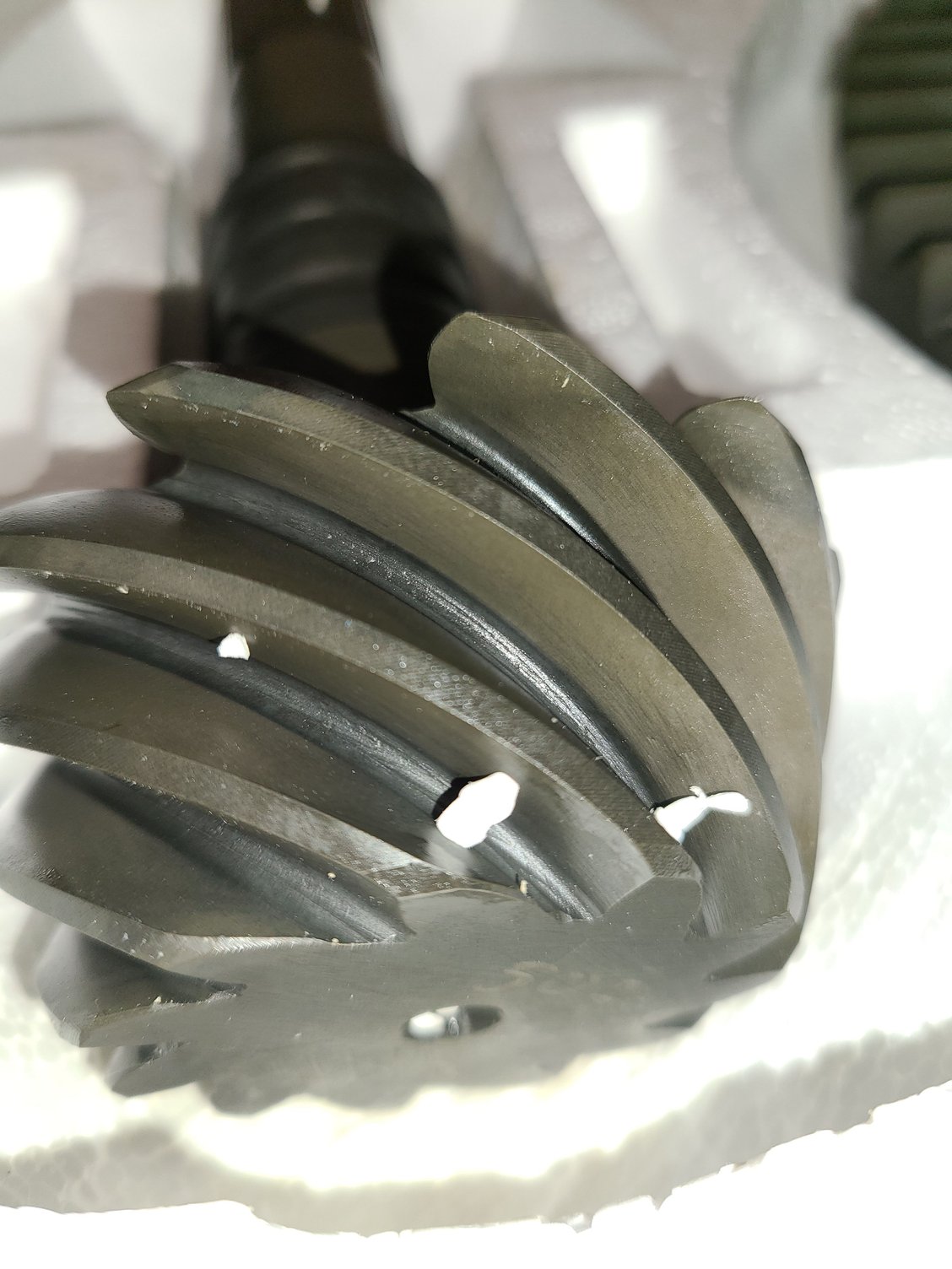

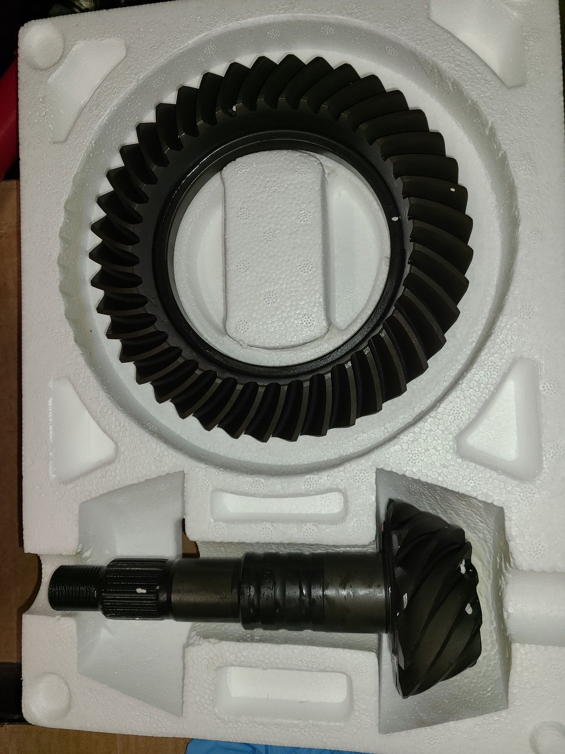

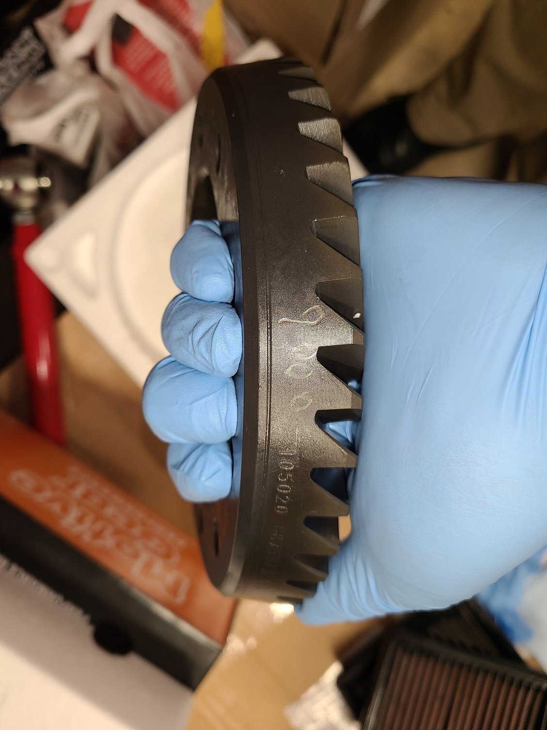

Honestly can't believe it, but all the 10 bolt parts came today, and they're exactly as advertised! These less than $300 of parts would have been $760 at summit racing! Now I just need to decide it I try them out or return them and get a 'real' rear end for more 10 times the money... I will say the 7.625" gearing really is quite small...
I will say though, the Motive Performance gearing looks really nice , well made and machined. And, that is coming from the engineering manager of a company that manufactures industrial gearboxes!
I also got fresh C clips and a crush sleeve eliminator shim kit for setting pinion preload from Yukon! Sounds like i still need a shim driver and a bar style 0-80 in-lb torque wrench for checking pinion drag, and I would be about ready to do the job!

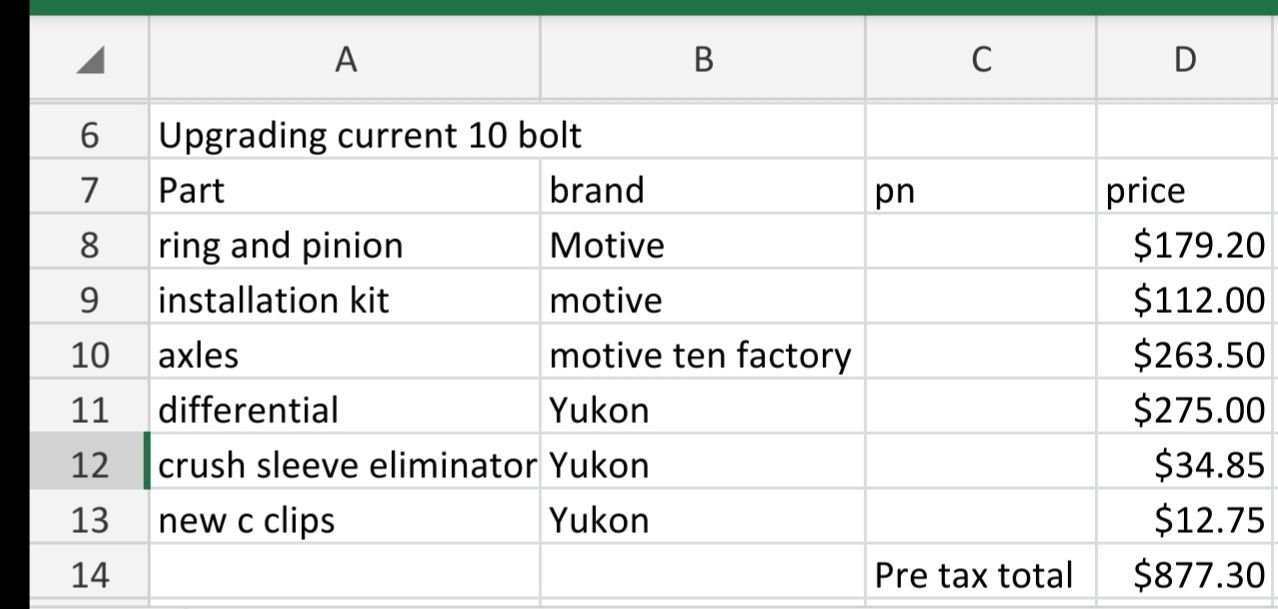

So I need a sanity check here... I know I need to go 3.73 for ratio and my two options are a whole new rear axle assembly, 12 bolt, S60, or Ford 9", which at the very least looks like it would cost $3500 plus a new drive shaft, and whatever it costs to get rear brakes sorted out...
Or, I rebuild and beef up my 10 bolt. I was leaning toward the new whole axle, till I started finding some really good deals on components and now think I could fully rebuild and beef up my current 1991 10 bolt for about $877. Even if this doesn't last forever, it still may be the right choice for the next few years... I could return every item at this point and go full axle assembly, but I'm leaning more and more toward giving my 10 bolt a chance... I alredy have a cast AL cover with bearing cap supports, I plan to weld my axle tubes during the rebuild, and for this money, I'll be replacing all bearings and seals, get a new yukon limited slip, new axles from the stronger new material with a beefier profile, new gearset, and I'm running an auto with 2600 stall converter, so there should be no super intense "hits" on the rear end. My engine should make around 475 hp once I finish tuning. I estimate it to be around 410 hp currently...
What are your thoughts? Could a 10 bolt built this way last, or is it a waste of money? Some of these deals I found are really good too!
