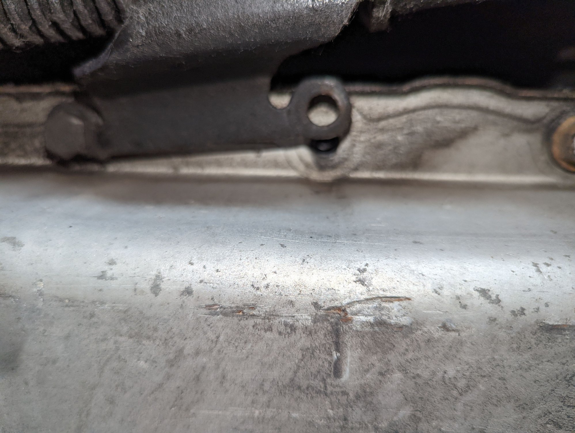

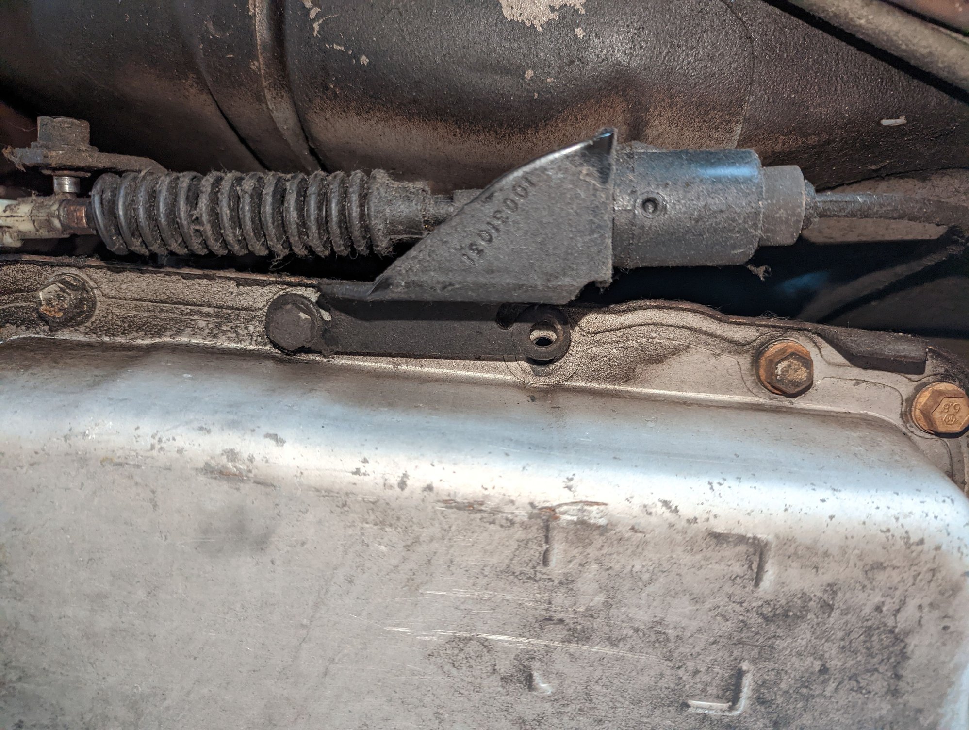

Eventually it stopped shifting altogether. Looking under the car, noticed the cable came loose. Seems like the cable has a plastic fitting and it fits over a little metal nub that's by the transmission oil pan. Is there something missing here to keep that attached to the nub? If not, the issue is probably that the two bolts that keep the shifter line close to the pan are missing, so the line has a lot of play and not lined up correctly with the nub. Hoping that replacing those bolts just works.

That cable end just sorta snaps over the mushroom linkage. No retainer or anything. Yours looks largely OK from what I can see of it.
Yes having those bolts that hold that bracket not there, is about guaranteed to make the whole deal work ALOT worse, since the way it works is, the cable outer is fixed firmly to the transmission, while the inner emerges or retracts to operate the linkage. No firm fixing, no push on the linkage when the inner moves.

Bought a replacement bolt and tightened things up. All seems well now.
