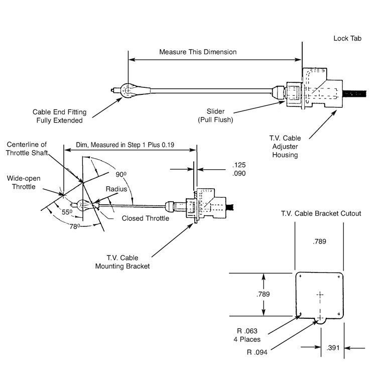

I've kept a pressure gauge on my freshly built 4L60 and regularly monitor it. This way I know that 1), I've got the correct pressures as per the book and 2) I can note any changes that might be indicative of something having gone sideways.
There's also a more accurate way to adjust the TV cable than the ratchet release method as described above.
This is dependent on having the correct TV cable bracket geometry. If what you have is OEM stock, then you're ok there.
The most critical criteria here is that the cable is fully extended at WOT.
With the TV cable disconnected, crank the throttle to WOT and measure from the bracket to the pin on the throttle shaft that anchors the cable. That's measurement 1.
With the cable still disconnected, draw the cable out to it's maximum extension. Do this with the ratchet in it's current position. That's measurement 2.
It's not super critical where you measure from but rather the measurement is taken from the same spot. I use the the leading edge of TV Cable mount (where the plastic bit inserts in the metal bit)
Measure 1 and 2 should be the same.
Since measurement 1 is fixed (unless you've an adjustable TV cable bracket as I have) then adjust the ratcheting part so number 2 matches number 1.
The important thing is that there is no slack in the cable at WOT and maximum pressure is achieved.
