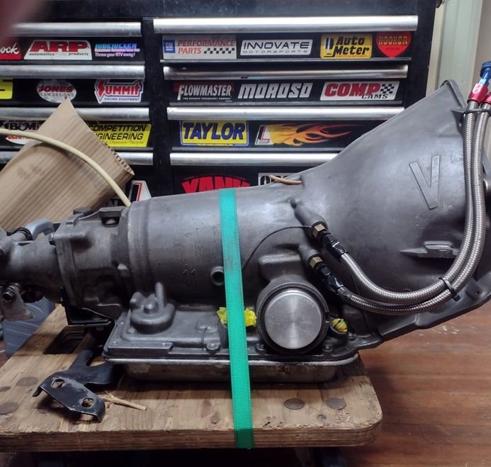

I'll lay out some of the difficulties and workarounds I've come across both recently and in the twenty plus years of doing this.
If you have a car lift it's a little different but if you're like me and doing this in the driveway or garage, the first thing is to get the car up as high as possible. The transmission on the jack with the dipstick tube in place makes getting it into location under the trans tunnel a task all of it's own. Last time, the rocker panel was almost 24" off the ground. I also remove the driver's side tire to get access through the wheel house. I have to come in sideways and the area of the wheel arch allows the bell housing to pass through. I did it once with the dipstick removed as it adds even greater height requirements. But trying to drop the tube in once the transmission is positioned is an almost impossible task.
Dipstick tube: See above but I'd have it installed and work towards getting up high enough. It's a choice between two struggles!
Engine tilt: The further back the better for bolt access. I also use a 3' long extension and a swivel 9/16th's socket. I also put a strip of electrical tape across the socket opening so as to provide a friction fit for the bolt. Saves me retrieving the dropped bolts a dozen times or more.
Cooler lines: Long ago I put together some AN flex lines about 18" long that hang off the transmission. During installation I don't have to access that confined space where the lines attach to the trans. That said, I don't use the stock routing for the lines. I've a transmission cooler in front of the rad and have plumbed hard lines into that. That AN to hard line connection is on the passenger side frame rail so access is ample.
The transmission before this current one. AN lines attached.
A prototype of the flexible lines before AN was incorporated.
That's about it although I'm sure something else will pop into my head about the install.

Going forward. Got the thing out today.
I actually took the jack and pressed the tranny upwards, tilting it forward, which made it a little bit easier to get the two top bolts from above. Distributor cap was/is the only thing that had to come off. I could take the two bolts from the passenger side and not have to fight with the brake cylinder & booster.
Getting it back up will of course be harder.

I also switched the speed sensor thingy, from older gear driven to newer inductive. Back when I installed the Fitech (and scrapped the old ECM) I couldn't get the stock speedo signal to work with Fitech but solved it with a Dakota Digital SGI-100BT. taking a signal directly from the sensor. I'm hoping the DD also will solve this change of sensor.
I will also change the "metal linkage part" (me and words.... ) , where the shift linkage goes, to from the older to the newer.
I will put a corvette servo in the new.
I learned that:
1. Draining a tranny means there's A LOT of fluid left and it will spill all over you. It comes from the tv-cable hole
2. A torque converter is way heavier than it looks.
Question: Which torque converter should I use? The newer 94-96 sat behind a LT1. Could it possibly have a bit higher stall?
I found that both removal and installation of the bolts was best achieved with the engine tilted back as far as it would go. The distributor has to come out in this case. All bolts are then accessible from the bottom with a 3' extension and a 9/16ths swivel socket.
And as for the install, as I had mentioned, building a cradle to fit to a small floor jack is a game changer.
A converter selection is a deep subject all on it's own. I've had several (around 5 or 6 I would say).. All but the last one were aftermarket off the shelf versions (TCI times 3, a no-name "high stall" and a couple of others). This time around I had one professionally spec'd. It's awesome!
I can't comment on whether the LT1 would have a higher stall.

And now it's in place! I jacked it up with the dipstick tube in place, running back and forth navigating the tube up. It was a real workout. Little over halfway up I took care of the cooler lines.
When the tranny was all the way up i took another jack in the rear just to adjust the final angle, and then just yank it onto the guide studs and start threading the bolts in. Next weekend I hope to connect everything, fill it up and start it (on stands).
I guess I have to mess with angles since the torque arm was loose.
Sore muscles in my whole body today. But man Im glad I got it back and didnt destroy anything (including myself)

I've tried different methods but installation with the tube in place, although making for some interesting acrobatics as you've learned, is far easier than trying to get that thing to drop in after the fact. I mangled one tube so badly trying to twist and bend it into alignment that I was forced into a replacement which also meant getting the transmission down again and fitting the new tube.
As for angles, unless you have an aftermarket torque arm with an adjustable bar, there's no means to change any angles. I've a UMI TA which allows the pinion angle to raised or lowered and that, combined with the (yet to be installed) Hooker crossmember allows for the angle of the TA to be raised or lowered at the front. There are chassis tuning benefits to both adjustments.
