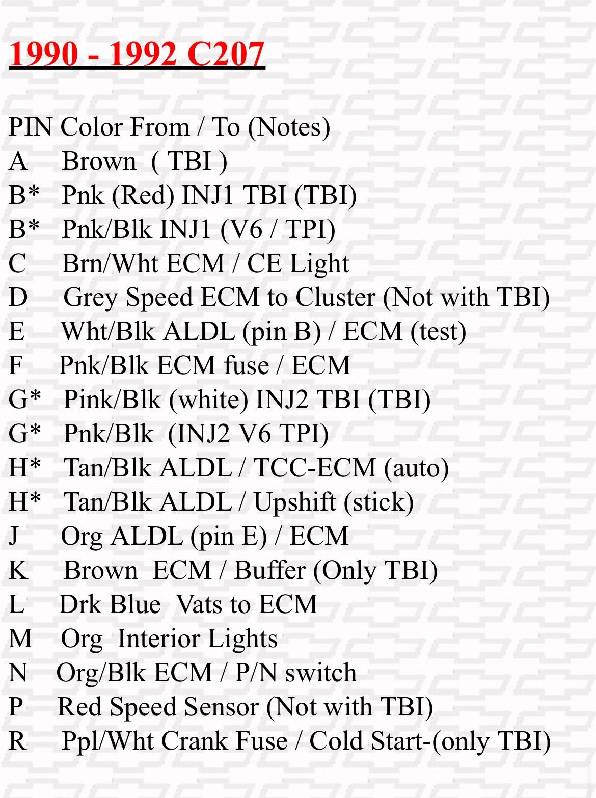

Old Dec 23, 2025 | 07:13 AM
Jlands's Avatar
Joined: May 2025
Posts: 49
Likes: 9
Re: 1990 iroc z VSS wire location in dash help?
Hey, I've been going over this chart and I don't understand. I don't see the vss wire in this list.
Old Dec 23, 2025 | 08:14 AM
D cavity grey wire
Old Dec 23, 2025 | 09:02 AM

D cavity grey wire
is this after ecm? Was wanting before exm. Need tc lockup managed as well.
It’s output to ip, before is at the ecm yellow and purple

D cavity grey wire
Really appreciate the help. Decided to tap the a6 wire for power and hook directly to ecm. I see you suggested on another post. Up and running and works like a charm.
Thanks again.
Also, I had jumping at idle with the setup. The cure....
RUN B11 DIRECTLY FROM THE SGI-100BT instead of from the 7730.
