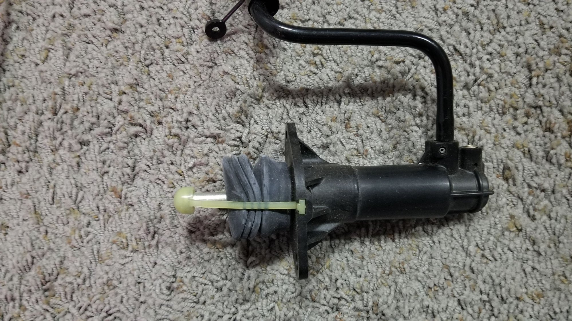

Did you change the slave cylinder or remove the plastic cap off of the tip of the plunger of the slave? When you cut the straps that hold the plunger back, the plunger pops out and into the indentation in the fork, and that plastic cap insulates the tip to prevent metal-to-metal contact against the fork. If the cap is gone or worn through, then that contact point might be the source of the chirping.
With the engine running, lay under the car and touch the fork, slight pressure should do it, like when you put your foot on the pedal, and see if the chirping stops. If that solves the problem, then a bit of heavy grease there might help. If the cap is intact and not worth through, and touching it solves the problem, then the vibration would likely be coming from inside the bellhousing, like maybe the fork on the pivot ball, or maybe the fork isn't attached to the bearing correctly.
I had that chirping for years, but it always went away if I touched my foot to the pedal. When I finally looked for the issue, I could see the plunger vibrating against the fork; the tip of the plunger had worn through the cap. I put slight pressure on the fork with my hand, and the noise stopped. When the slave eventually blew, and I installed a new one, there was no more chirping, due to having a full cap on the tip of the plunger again.

Ahhh thank you for something new to look at!
