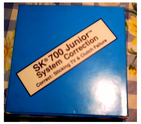

this kit any good ???
any thoughts on this transgo shift kit

well I guess it corrects the premature downshift between 4 to 3rd.

It will correct the primary causes of complaints and failures in your 700. It will not however provide 'hard' shifts or increased manual control as the Reprogramming Kit would. Also, since it is meant for professional use it doesn't go into great detail about the installation of it. It is assuming you know what you are doing. Do you?
It also will not correct the TV Geometry fault created by using the 600 Holley with this tranny.

I'm learning all the time Leo I'm gonna oreder the reprograming kit from pro-built. On his website there is also an upgrade kit that sells along with the shift kit for 20-30 bucks..dont remember exact. Do you know what the upgrade is ??? Hey I read your posts all the time, thanks for all the help.....:hail:

An "accumulator kit" is listed as an option to the Street/Strip kit.
Judging from eariler posts the kit inlcudes (at least) an accumulator valve that can provide nice 1-2 part throttle shifts and firm 1-2 WOT shifts, if the whole accumulator system is set up correctly. I would like to replace my 1-2 & 3-4 accumulator pistons & springs as well, but I don't know whether these are includeded in the ProBuilt accumulator kit. I hope ProBuilt will answer.
