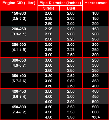

Look what I found
Ok so it looks like our best bet if you arnt going to mod your car over 150 HP is to get a 2.25" cat back. 2.50" Cat back is good for 200 HP.
I got this chart from the Dynomax Website.
