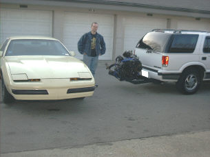

do what I had to do to get the 3.4 off the back of the blazer: attach engine stand to motor while on truck, ease off w/help a some freinds so when engine off back off truck, it's already in the stand

you can see how much the blazer was draggin a$$ in this pic
usually the third tail light is taller than me. just cause it's a six don't mean it's lite.
