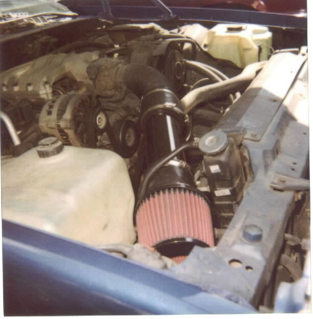

that is weird... just stalls, huh? the problems probably deeper than i can give you advice with, but i can help you out with the intake. i'm sure if you ran a search you'd get a ton of info on this, but i'll try and save you some time. you need a conical air filter (recomment k&n, despite the fact that i'm using a tenzo, ), next visit your local home depot and pick up some 3 in pvc piping (probably gonna have to be cut to size), then get two pipe connectors (big black rubber tubes with clamps on either side) it'd be good if you can find an elbow connector. anyway... the rest should be self explanatory. remove everything you've got in there already, except for the section leading directly into the throttle body. now, you get to really appreciate your '91, because you don't have to deal with the mass airflow sensor. that's it!!! it may not be cold air, but it's more air.... if you really want cold air, try building some sort of head resistant box around the filter, and try to run some piping up from the passenger wheel well. i didn't do this...... yet .... but just thought i'd let you know about it.
here's mine:
entire post dealing with this:
https://www.thirdgen.org/techbb2/sho...hreadid=119719

Hi RealDeal,
Thanks for the info on that air induction setup! I think I will
be doing the same thing to mine! As far as the stalling, since
it's only a "rare" occasion, I'll have to do a little "work" on it
day by day. Like fuel filter, fuel injection service, recheck my
throttle body, and inspect my IAC valve for clogging. All this
stuff is the easiest to start with.
I was originally going to install the TPI dual snorkel setup with K and N filters for my car, but this could run up to like over $100
for this setup.( $26 each filter, about $50-70 for induction on Ebay).
So I think I'll go with just a single cone K and N filter for like about $20-$30, and stop at my local Home Depot for the other stuff ( like $20 total?). This is WAY cheaper , plus will have that "custom" look to it.
I will also build a "heat resistant" box around the filter, so It will
really look like those cold air induction setups that they sell for the 93-2002 F bodies that sell for like $300!!!!!
Thanks for everything! Now I can't wait to build one!!!!!!

awesome! take some pics when you're done so i can take a look see... goodluck, and enjoy your 40 (if even) dollar, intake.

RealDeal,
Have you noticed a differance on the performance part of it?
By the way, Summit has a 3" diameter flange round style K AND N filter for like $36. I think there's two different ones. One has a 5" diameter, the other a 6" diameter. The price differance is only about $1. It claims to have about 900 cfm of air flow through them! That's pretty damn good!
Check it out here:
http://store.summitracing.com/partdetail.asp?part=27049
P.S. Will PCV pipe give any problems? Like heat, smell, melting,
stuff like that? I saw one article where a guy used this setup for just a "trial fit". Then had an exhaust shop bend a 3" exhaust pipe to fit. Then he painted it. Is it worth the extra $60-$70 to do that? Let me know how yours is holding up!
Thanks.
Old Aug 6, 2002 | 01:38 AM
RealDeal's Avatar
Joined: Apr 2001
Posts: 144
From: Charlotte, NC
i've had mine on for atleast 3 months... absolutely no problems. i've never heard of any problems resulting from the piping. i imagine that with it not being metal, it might even have a better chance at staying cool while air flows through it in that boiler room engine bay, hehe. i'd save the money, personally. might look nice appearance wise though..... so i guess it all comes down to your preference.... i know, a lot of help i am, right?

Along with the 3" PVC pipe and connectors. After that is in and working, then I will make and "housing" for it,to help cold air in!
I don't know, kind of material I should use? Like plastic or sheet metal???
I forgot, with size drill hole do I need to screw in the
air temp. sensor? Was it 5/8" ????
