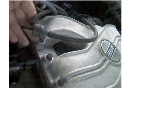

Ok I searched my whole vacuum line system, (shew!) and other than slightly cracked (but usable) canister lines, I found one broken off vaccuum line, what does this do? (see pic) A rotten hose broke off it's where a hose from the firewall connects to the branch at the back of the plenum? what does this do? does it go to the computer? could it cause my woes? lmao.
The part you've indicated by a "?" is a valve that only allows airflow one direction. I broke mine while fixing another vacuum leak. I'm not sure if that's the part that's broken, but I had to go get one at the dealer (~$5) cause kragen didn't have it. But a vacuum leak from that area will definently cause problems.

This is the hose drawn in the left of that last drawing, see the short, rotten hose on the end? I think it connects to...........
This..... To make a "Y" shape together with the Plenum output. The upper/smaller hose on this is slightly cracked, but it's on good. Anyway to test this valve?
That tubbed "T" damn, I know on my wifes corisica it was bad and caused all sorts of funny things. Went to autozone, me and her couldn't find it, but all be damn if our 2.5yo found it
. Put it on and it fixed idle, hissing, acceleration, heater problem. I suggest getting a new one, it was like 3 bux. Then get new hoses, or whatever else to fix any vacume lines that MIGHT even look bad.
. Put it on and it fixed idle, hissing, acceleration, heater problem. I suggest getting a new one, it was like 3 bux. Then get new hoses, or whatever else to fix any vacume lines that MIGHT even look bad.TGO Supporter
BTW, yes that connects to that, get a new "t", "y" thingie, and put that on it. That is most deff a problem!!!!

I belive those lines go to the vacum ball, and a two other things I can't rember off the top of my head. If I remember corectly one is the heater diverter vale and on my '92 3.1L one goes off to the map sensor. At any rate it's the vacum leak that is causing the problem.
