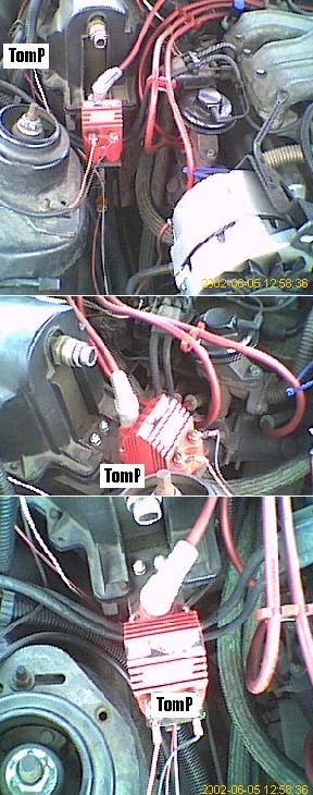

Not explicitly, you might be able to find a set that fits. I've always bought the universal wire sets, that way, I can run them the way I want. I used to buy #31179 (summitracing.com part number search for MSD-31179), it's the 6 cylinder HEI set, with long spark plug boots. You can actually put the plug boot on the plug, and give the boot a little "bend" to keep it off the engine (and hot spots). But now I buy MSD-31199, it's the same set, but with 8 wires, for only $3 more! All the wires are much longer, and you wind up with two spares. Not bad for an extra $3.
As to running them my own way, I don't run them around the corners of the motor; that's too much of a pain in the butt- I've got better things to do with my time. Plus, I've made it look much sweeter, as you can see by the passenger side of the motor in my "how I mounted my Blaster SS coil" picture series:
Attached Thumbnails does msd make a set of superconductor wires for our 2.8?-tomp-coil-all-views.jpg
