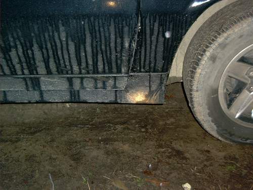

Old Feb 20, 2003 | 07:27 PM
85SportCoupeto89RS's Avatar
Posts: 2,760
From: Cove, Arkansas
Car: 85 Camaro SC
Engine: V6
I took a pic of the filter. ITs right behind the driver seat and just infront of the rear driver seat.
Old Feb 20, 2003 | 07:29 PM
Posts: 2,760
Car: 85 Camaro SC
Engine: V6
Where the light is on the gfx is where you can find the filter behind that about a foot, its up in a cubby, not exposed to any road obstacle.
