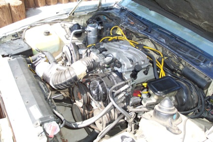

Old Nov 17, 2003 | 11:34 AM
  #78
KED85's Avatar
Posts: 7,604
From: ****SoCal, USA****
At my local LARGE downtown LA yard I pay/paid $800 & $900 respectivly (see sig).
Average on this board seems to be $500-600.
Price range has been $210 (Ohio) to my $900 (LA, CA).
Find the best low milage running used 3.4 engine ya can. Everything swaps & works very well.
I've done TWO SMOG TEST ONLY on my 3.4 Firebird & pass w/flying colors!
Enjoy the research, enjoy the hunt, enjoy the results.
I can get my source to ship up north is so desired. I'll pass the guys number if ya hit me up in email.
Attached Thumbnails V6 digging 6 FT deep Any tips b4 i shoot this car-3.4-20f-bird.jpg
