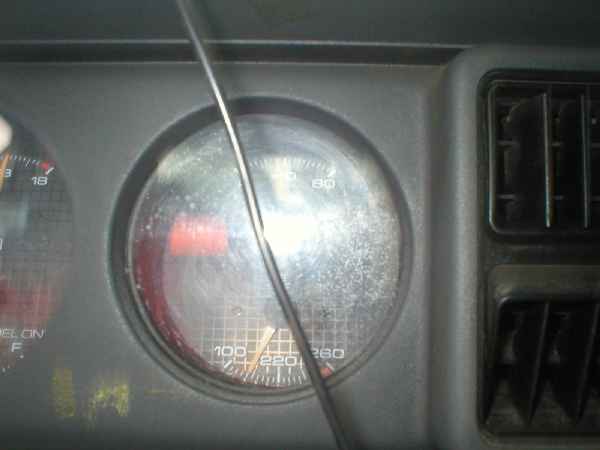

I feel for ya all.
With my true ram air and home made air dam [ I just used aluminum insted of floopy rubber], I have a hard time just reaching proper engine temp. Let alone ever warm enough to even consider letting a fan run.
This is as warm as it will get.
Of corse if I sat still for ever it would get hot. I have the fan on a togle but have not needed it.
Matt
