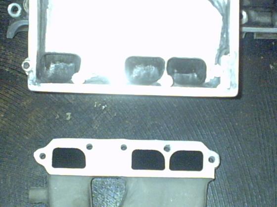

Here's a pic of the ported runners and plenum match- Note the comparison of the stock runner size of the stock plenum. I still have to do final sanding and rounding of port mouth, this is just to show maximum port size openings.

So... nobody wants bigger runner ports on their list ? Just getting back on topic- I was so proudof my work I had to post it, thought they are figgin huge. I focused on rounding out the inner material to keep integrety of the wall strength, rather than just larger square ports. (radius' are stronger than squarish corners )

Done grinding and polishing the upper runner mouths- Neighbors must love me- compressor running all evening- I have to get over to the family shop and bring home the MIG to button on the top, then tap the vacuum fitting and fab the throttle bracket fitting- No EGR - I plan to delete that in the chip. Also have to gring out a groove underneath for a 90* fitting of the schraeder valve for a fuel pressure gauge to fit- this won't be fun. Here's the polished port pics- I rounded the opening edges and polished the inside a bit to clean things up.
