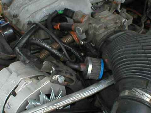

I run and open vented PVC system.

Uhh.. Gumby.. I think you're on the wrong thread
