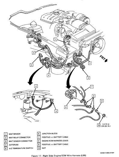

HMMMMMMMMMMM!!!, I wonder what the letters FP in FP/INJ2 stand for!! Also, that fuse on the right hand side of the engine bay that is supposed to be for the fuel pump. It also controls battery power to the ECM at pin B1 and C16.

Ok, off-topic, but I have to ask....DUDE, where do you get all these diagrams and flow charts? Every post I see you make, you've got a diagram or chart for it! It's maddening!

To Nixon1, it's a trade secret but I have the GM service manual scanned into my computer so I can just print out the pages I need or refer to my laptop.
