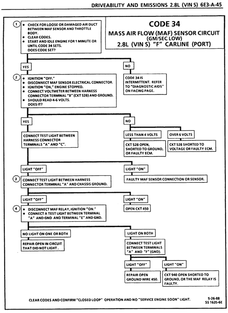

MAF sensor error #34
I'm trying to get this '89 Camaro RS w/ 2.8L MPFI to run, and found this code while paper-clipping the ALDL.
Code 34 ??
Any help appreciated, thanks.

Code 34= Mass Air Flow (MAF) Sensor Circuit (GM/SEC LOW)

Thanks Trickster !!!
