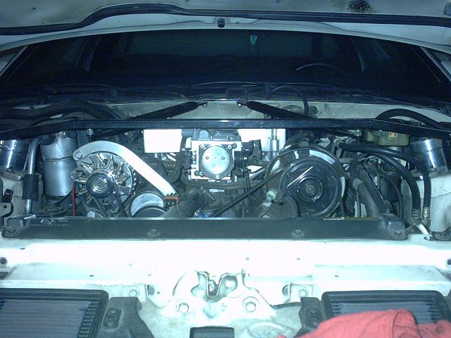

Thought I'd pop in breifly to say hi and show how the plenums going. Had to fix a little vacuum leak so I gave it a test fit while I had the top off. Been waiting for a reason to pull her apart for the test fit and to line up the linkage, etc.
Dean

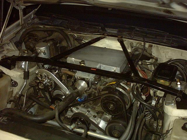

That thing's come together in an impressive sort of manner.. mad props

Looks sweet! Can't wait to see/hear more! Hey where'd that alternator bracket come from?

Tom, I made the alt bracket out of some 3/16"stock, just cut it out, rounded the edges and polished it. That's a V8 TPI 140amp alt on there so I needed a custom bracket support.
The plenum is NOT finished- just a test fit while I was working on some vacuum lines. I had to mark where the linkage bracket screws to it so I can fab that up. Top is still not attached either, but I did temporarly seal it and fired the motor with it on- it idled stable.

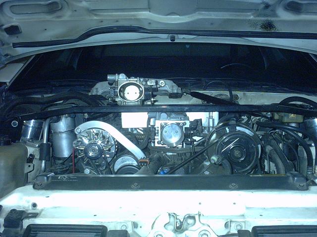

Here's a shot of the stock plenum and TB sitting on top for comparison.

Here's a better shot of the alt bracket. Look close in the picture and you will see one of my custom lower frame braces also. This boxes the steeringbox in the rear also (GW wonderbar in front). This is something we can do that the V8 cars can't.

Originally posted by TekViper
my question is, why would GM make the manifold they came up with for these engines if just an empty aluminum box would work better and be much cheaper to do? im not trying to be a smart ***, just want to know why this is better and why its not like this stock if its so simple. emissions? noise?
Because the stock cast design was adequate for the stock economy 2.8/3.1 engine at the fuel consumption and rpm range of intended operation- it was a budget minded engine package.
My design is not intended to be bolted to a stock motor/ hence why I keep saying it will not go onto this motor. The motor it will feed will produce aprox 240hp naturally asperated and exceed 8000rpms- not a stock 140hp motor or even my slightly modified 2.8. I explained this a few posts above already.
Pasky and Brobert, thankyou for the compliments- I will try to behave. Although I don't think EDE will keep me around long enough to worry about it.
Edit: EDE banned my cousin Derek thinking it was me (Halfpint) He's pissed.

As asked before, how does your design differ from the stock design? The only way I see getting rid of the tight bends of the stock intake would be to raise the upper plenum giving you the room to turn that 90* (I thought it was 135*) into two 45* bends. That intake appears to sit at the same height as the stock one so how did you accomplish your goal of dividing the angle into two smaller ones without using more length. Plus, increasing the runner length will add to hp and torque. I am the person who modified the TPI intake to fit my 3.4L. I don't care for the tight bends involved but I just needed to fab something for it fast to get the motor running. I am working on another one now where I use two lower plenum sections to help cut down on the restriction seeing how most of the restriction in the intake is in the upper plenum. Here's the link to my site:
http://www.angelfire.com/crazy3/jimsfirebird/
Just click on the button that says '3.4L intake'. And please forgive all of the crazy insert ads.
Jim
Old May 14, 2004 | 10:41 AM
  #43
vsixtoy's Avatar
Joined: May 2004
Posts: 1,340
From: Orange, Calif
Car: '87 Cam RS V6
Engine: Top Secret
Transmission: DYT700R4 custom inerts and conv.
Jeriko, Heres a camparision shot of the internal of a Holley Stealth Ram/ and my design- same basic premise. You have a larger volume plenum to feed from and shorter runners for a more direct straight shot and higher rpms. Longer runners add HP down low. The roof of my unit is taller than the stock unit and much more open to feed the ports.
my 90* example was just that- an example that 2-45*s flow better than 1-90* bend. I do realise that the stock upper to lower bend is aprox 135*, But thank you. I feed directly into the port with a mere 45* bend from the plenum chamber through much larger port openings.
thats a lingenfelter super ram, not a Holley Stealth Ram.
while your design is a big improvement, i still think a new lower intake would be needed to fully optimize the motor.. notice the SR uses a diffrent lower base....
Exactly.
Also, just because you have opened up the upper plenum the air still has to bend 90* before it goes to the 45* bend of the lower plenum. The air doesn't simple appear at the TB and magically shoot down the lower intake. It still has to go through the TB bend towards the appropriate runner and then bend 90* downward and then other *45.
But still, I like the idea. I just think that it needs to sit at least two inches higher.
Another question, is that box welded onto the lower plenum?

vsixtoy's Avatar
Joined: May 2004
Posts: 1,340
From: Orange, Calif
Car: '87 Cam RS V6
Engine: Top Secret
You guys need to re-look at the middle and lower intake manifolds bolted together. You can't get a strighter passage to the head than the stock design, and mine has been opened alot more. So you are saying I should put some bends into it?
As for the air still having to bend 90* into the port (then the 45*), thats the whole point of larger volume plenums- your not getting it. I have alot more open volume to feed each port as it is demanded-
rather than funneling throiugh the longer runner to the smaller chamber stock plenum. This also has both 90* into runners AND 90* into the 45* minddle.
Air intake is not a constant flow into each port- the air pulses/ there is however constant air flow into the TB filling the larger plenum area to feed each pulse and reduce scavange- hence the larger TB also.
* Please note that I am respectfully and contructively debating- Thanks guys*

Jerriko 3.4's Avatar
Joined: Feb 2004
Posts: 182
From: Rockford, IL
Car: 1987 Firebird Formula
Engine: 3.4L 207 V6
Transmission: T5 W/C
Creative discussion is awesome.
I must have missed the part about suggesting more bends with the intake. I don't agree with that.
That larger volume of air does you no good since it still has to fit through the lower plenum. That is your bottle neck. To get the idea to work great, you would have to port out the heads, intake and plenums. Increasing only a portion of the intake does you no good. I know you plan on during this later on but you have said nothing about changing the lower plenum. If I go buy a large and small drink from McDonald's, I can't drink the larger drink faster simply because there is more volume if the straws are the same size. Increase the straw and increase the total flow. I understand that you have increased the potential volume but doesn't do you any good if ALL parts of the intake are increased.
Jim

pasky's Avatar
Joined: Apr 2003
Posts: 3,563
Car: 1991 RS Camaro (Jet Black)
Engine: 95 383 CI (6.3) LT1
Transmission: 95 T-56
Good example, but I still think he will gain a bit even without modifying the lower plenum, although he will see a much better gain if he does. By doing what he has done, he still knocked off a restriction the upper plenum has which is those long skinny runners. The air can get directly down to those lower plenum ports and maximize the space they currently have which I don't believe the upper plenum did. But yes, much is to gain by changing or porting the lower plenum.

FbodTrek's Avatar
Joined: Oct 2003
Posts: 1,668
From: Houston
Car: 86 Berlinetta 84 MonteCL
Engine: 3.4 MPFI 3.8 229
Transmission: 700r4 T350
His design is sound
What he's doing is getting rid of the restriction that the tight bend causes to flow dynamics. He has, in effect, pushed his powerband higher in the RPM band. By using the larger plenum volume, he is able to successfully feed the motor at the higher rpms (which is what the motor is designed to make power at). He has no reason to lengthen the runners, he's going to be pushing to 8 grand. That bend is a huge restriction in itself on these motors, but that was the only way GM could make the torque curve low enough for what they wanted, and still fit under the hood. I firmly belive that lessening (if that's a word..) the curve would net a decent gain. I'll be doing some tweaking on the dyno with variable runner lengths soon, I'll post the graphs.
