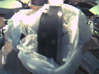

This is a bad harmonic balancer

YOU ARE SO BLOODY LUCKY that did not explode on you.
Imagine IF that separated at high RPMs, while driving....
You are so Bloody Lucky.
Now go buy a lottery ticket!

how is it bad? Also, if it IS bad, what does it do to your engine performance wise?

It would've been bad, very bad, if the outer ring would've slipped at 2000 RPM, then BOOM, dent in the hood, and BANG no more 2.8.

When a balancer separates at high speed, it's like a bullet being fired.
But the bullett weighs about 3 pounds.
Dent in hood is least of worries.

Before I took a trip to Pick A Part, I called the dealer to see how much a balancer would cost. $239!!!!!
So I pretty much said, nope too much $$ for me. I did get the current P/N for the balancer tho.
10146863 will show up on GMPartsdirect. I think their price is $160 + shipping... still too much for me.
$21.43 + $2 admission off a Fiero 2.8 was much better!
