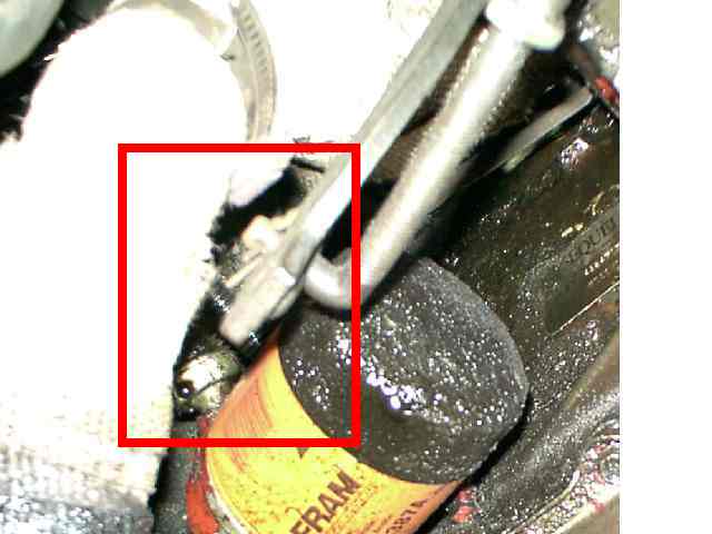

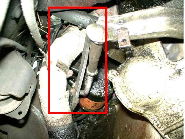

pics
Here are some pics of my driver side exhaust manifold where I think the clutch linkage may be a problem. If only I knew how far how far back the headers extend compared to the stock pipes. I couldn't get a very good angle so there is a tiny bit more space then it looks like in the pictures. Maybe someone can tell if they will fit by looking at them. I really hope they will fit because to replace it with new stock pipes would be more expensive and not as much fun as headers. Oh yeah my manifolds are wrapped with insulation because they have leakes that are starting to burn my wires incase you where wondering what that was on the pipes. Thanks you guys ROCK!!!!!

Yes, that will be an issue.
No headers for you

Just email pacesetter and ask them. They are fixing the fit problem with the larger oil filter, maybe they can tell you if there will be enough clearance for your linkage.
edit: I'd send them that third pic you posted.
