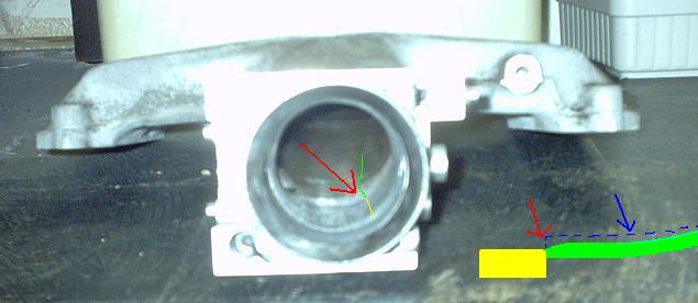

62mm TB attached to a stock plenum ported max to fit. I did npt want to try and port the green section any thinner than I did because it was just getting too thin. I did prt material off of the plenium about 4 inches up inside the plenum from the TB lip, but I just did not want to make the rest of it any thinner to match the 62mm. I only ported the 62mm at the tapered lip I show and realized I am running the risk of breakage or even porting a hole right into the casting walls- this is when I decided to build the new plenum.
The blue line shows aprox stock plenum wall thickness.

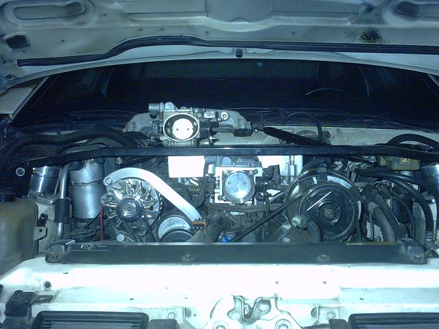

I just setup the TPS on the 62mmTB and RTV'ed the TB to the ported stock extra plenum I have- going to try it out on the 2.8 tommorrow if I get home early enough to see if it will render any results on a basically stock motor.
I'll post results when I try it- by this weeekend for certain.
