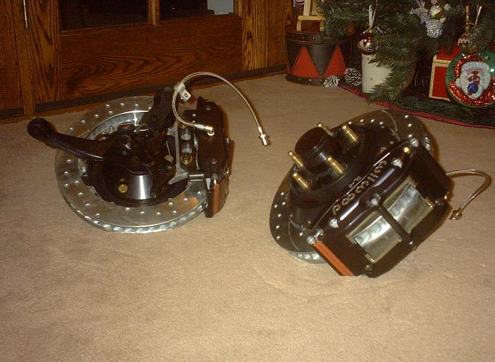

Stainless steel flexable braided lines- just like Earls performance braided lines, only custom made to my specs. It would be inpossible to run hardlines due to suspension travel.
Heres a pic that better shows the entire brake assembly. These are the largest brakes ever fitted to a 3rd gen under a 16" rim and are completely one of a kind.

Since whe are on the subject of suspensions, I'll show you guys a few things if you are not familiar with me over on the suspension board.
Here's a comparison to somewhat stock size(but not stock componant) factory 10.5" brakes and single piston calipers
Attached Thumbnails Struts replacement time?-c-documents-settings-office
