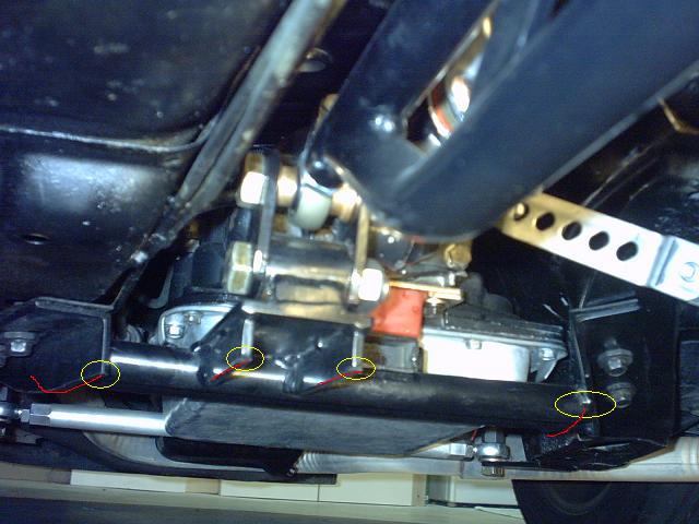

Its been that exact height for about 12 years and driven daily by my wife. It will scrape the spohn crossmenber on an occational very tall speedbump, but most speedbumps it never hits at all. Years back I put 1 set of 245/45-16's on it 24.7" tall rather than the 25.7" so the car sat 1/2" lower and looked goofy with those small dia tires. It also rubbed most of the time over anything so that extra 1/2" was a bad stance.
You have to remember that this car is very stiff so the suspension does not travel much at all when it hits a severe bump. It will travel mostly 1" with a maximum 1 1/2" travel at worst from stagnant ride height. These cars at stock height will have a suspension travel of about 4" or even greater on a severe bump.
So hitting a speedbump at 5mph my only compress my suspension a half inch where a stock soft suspension Camaro will compress about 1 1/2" on that same speedbump at 5mph. The nose of the car suffers every once in a while and I have repainted it many many times over the years. I am close to buying a new air dam peice because this one have finally seen better days. Its still the original. Other than that, If the bottom chassis of the car ever hits (which is fairly rare) it will run on the Spohn trans x-member braces that I rounded for that exact purpose to be used as a somewhat skidplate. Its the only thing that has ever made comtact. Note: the Spohn X-member hangs down lower than the factory stock trans x-member by about 3/4". But it solid mounts the trans and the torque arm unlike the factory unit.
You can see in the picture below how I angle grinded the two outer brace rails to absorb and glide over any hard possible groundout over a severe speedbump. It only touches at most the rear portions that I have circled. There is no paint missing on any portion of the angled plates in front of the yellow circles indicating that it never hits anything higher than that point. And even then it rarely hits these unless the "three" of us are in it on a large speedbump.

The picture shows the Bumpsteer kit and "red" aluminum tierods with rodend solid steering links. Not the section I circled shows where the gold colored spacers have been added to lower the mounting potion of the outer rodend so that the anle of articulation is back proper geometry through the motion of travel.
When a car is lowered without correction tierod angles, the motion of the tierod at stagnant ride height already starts at about level#2 or even slightly higher between #2 and #3. The what happens is during the suspension travel, the articulation angle only progesses upward futher dramatically shortening the distance from line a to line b distance. This geometry change through articulation causes the tire that is traveling upward while hitting a road bump to actually turn inward shortening the toe setting between the left and right tires and cause the tire tracking to fight eachother causing unwanted steer. By shimming and relowering the staring articulation angle back to about #1 position, the steering geometry remains as close to uncahnged as possible traveling form #1 to #3 positon through suspension travel and causing very minimal change in toe settings-thus not causing unwanted bumpsteer. Its an adjustment provision to recorrect the steering geometry to factory angles when the car is lowered.

We are turning this into the V6 suspension board
Applies to V8's also.
Here's a link for purchase. Disregard the picture on that link, and disregard the discription of what a bumpsteer does on that link- they both are wrong. It is the correct part # and the best price I found when I purchased mine a few years back.
http://www.sdpc2000.com/catalog/1635...-Steer-Kit.htm
This is a picture of the actually 82-92 f-body Baer Bumpsteer lit shoiwing how the spacers will adjust on topside of the rodend so the angle can be changed.

Ps- email me if you are interested in the Hotchkis tierod sleeves pictured there. I still have them and they are unused. I thought they would fit onto my truck but they did not (threads are larger on my truck than the Camaro) package is opened "partially", but all parts are there and never installed on anything. $40 + shipping.
They are a direct bolt-in replacement of the crappy stock tierod sleeves. These will not flex like the stock split sleeves do.
