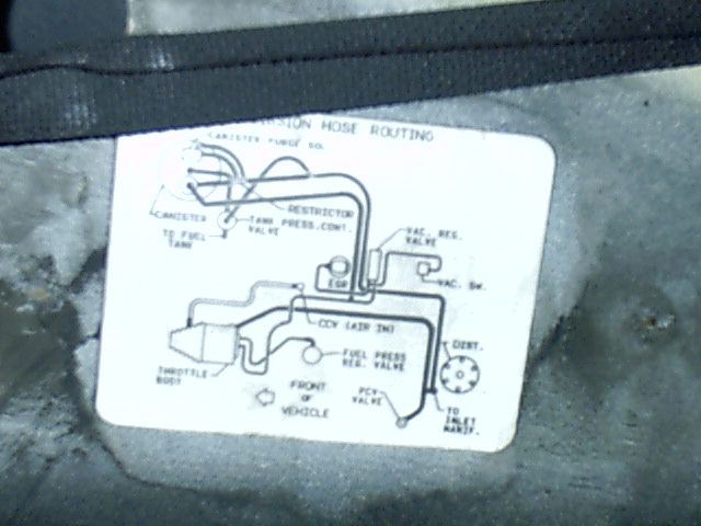

would anyone happen to have any kind of map showing all the vacume lines ????
Check the tuneup decal on the hood

go to autozone.com and the repair guides it should have a diagram of the vacuum lines for your car

Here is a 1985 smog hose set up
IF your car is NOT a 1985, your set up will be different.
But this may be a foundation to offer you.
I never saw you mention what year is your car.
Attached Thumbnails Code 32????-85-20firebird-20smog-20routing

In the smog set up yours is worlds different!
You do have that electric EGR set up.
And that's an expenive item to replace.
I would remove it, clean all passages, new gasket & see what happens.
I also hear that the FWD 60* V6 Stage Two or Gen Two EGRs are the same.
But your problem helped me I think.
I've been told my vacuum hose routing is backwards there.
This may be the cause of my cold morning early morning bucking....
