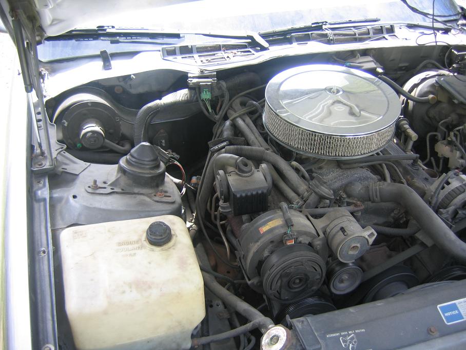

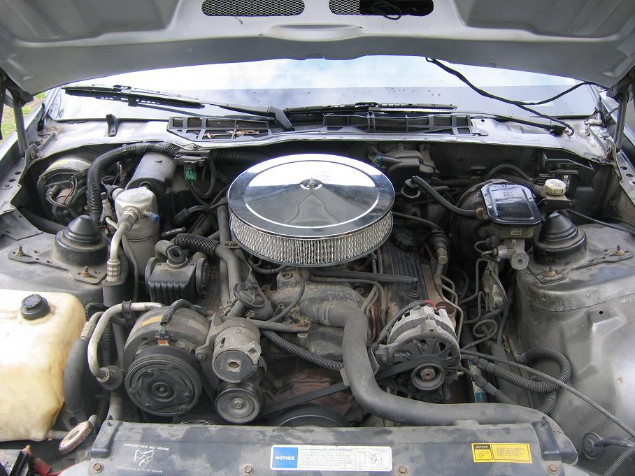

Are you just trying to get it off the serp setup? Or remove everything and put it a non-ac heater box? I just did mine, it took probably 30-45 minutes for everything, including removing the radiator to take out the smaller radiator looking thing that connects to the AC. I havent put in the delete pulley yet, but they arent too bad in price and only 3-4 bolts.
Heres a pic of where im at, just have the wiring left to do.
Attached Thumbnails how to remove the ac system...-before.jpg   how to remove the ac system...-after.jpg

Before on the left, After on the right. You can see it cleans everything up nice, and is supposed to free up 42 lbs. It should look a lot better once I get the pulley, and I'm assuming its the same for 2.8 as it 5.0? Correct me if I'm wrong, its still just nuts and bolts in the end.
