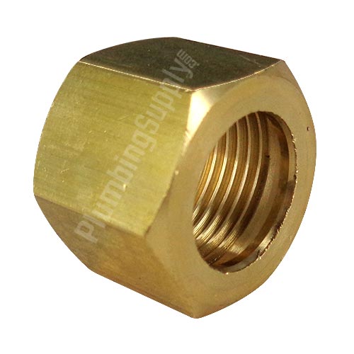

OK so nobody is answering me in the other thread. What would be the best way to reconnect the fuel lines. I read somthing like flaring the lines and using some sort of compression fitting? I was planning on the high pressure rubber hose but it sounds too much like a safety issue since they could blow out. If I did end up having to use rubber hose what strength and what kind of connectors should I use? The rubber hose would only be temporary. Like maybe a month. I would try and fix the lines the best way ASAP if it isn't in budget right now.

When I bought my '85 it already had this done to it. Basically they are brass fittings that you can get at just about any hardware store. You have to cut the lines, slide the nuts on each end of the lines, slide a pharynx on after that, and screw the together on a nipple that is threaded on both sides.
Not sure if that makes sense but, just go to the hardware store and tell them you need some brass fittings to connect some metal lines together. They should know what to get for you...key word "should".

The 2 inside lines are 5/16 and the 2 outside lines are 3/8. The brass fittings are pretty cheap. You should be able to get evrything just as cheap if not cheaper than the hose and clamps. I would just do it this way now and not have to fix it later. Both ways are purty darn cheap...but why not do it right the first time...for near the same price?

You need 4 - 5/16 and 4 - 3/8 of the sleeves on the left. 4 - 5/16 and 4 - 3/8 of the nuts in the middle, and 2 - 5/16 and 2 - 3/8 of the nipples on the right. (note: the pic of the nipple has the nuts screwed on already)
First cut your lines, slide the nuts on each side of each line, then slide on the sleeves, then slide the lines into the nipples and screw the nuts on. That should be all you need to do! Hope this helps.

I picked up the fuel line connectors they are a little different from what was described. Instead of those sleeves there are a sleeve that slips into the fuel line and has a flare on the end that is what seals it. It sould work fine.

Those won't work on hard lines, they are made for rubber/plastic. Wherever you bought the fittings, there will be a seperate area nearby that just sells the ferrels (looks like a sleeve that slips over the tubing, looks like the pic on left in post #9).

Nobody had the 5/16 fittings that I need. I found the little compression rings but no nuts. I ended up having to buy what I did before and buy the nuts and rings seperately. I went to Sears, Lowes, Home Depot, Advanced Auto, Pep Boys and Harbor Freight. I will have 5/16s hose for a few days until some of the other stores open on Monday.
