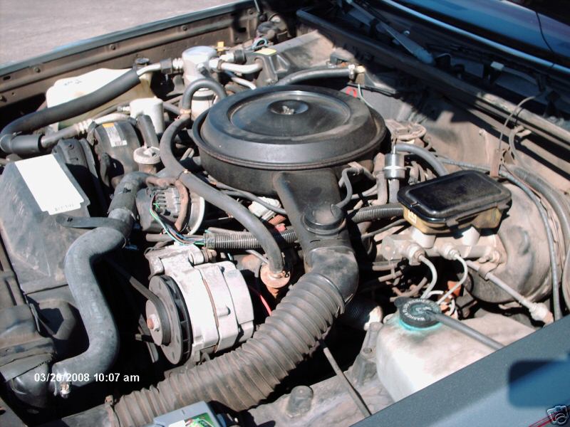

Originally Posted by KBcobra
bad news, i have to fabracate a whole serpentine belt system
Why would you have to fabricate an entirely new system, couldn't you just use the bracketry, along w/the rest of the pieces from a RWD non turbo 83-87 Regal? They're all over the bone yard, or do you prefer a serpentine setup...?
